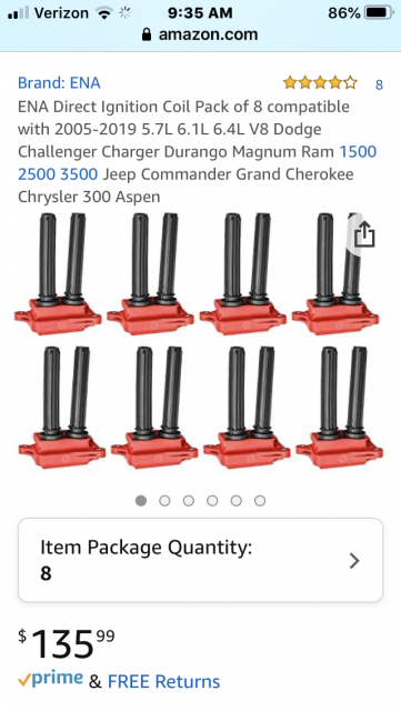

Coil packs could be bad as well, weak spark same as plugs with a gap to big under high cylinder pressures. You have another set you can try?

Coil packs were changed out spark plugs are new they are Brisk plugs 12S gapped at .028.
The Ecm is sensing something and going into a safe mode at high rpms with boost or no boost it doesn’t matter or what gear I’m in it’s like switching on a switch and then off again and everything is fine

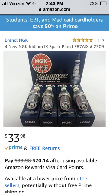

Try stock NGK plug gapped at .026”
3,703
8,724
These

These coil packs are made by MSD for this company, I have a buddy running them along with the NGK plugs gapped at .024” and they took just took care of his miss in the big end. 712E6C85-43D8-47F6-BFB5-E7A6636EBE14.png
