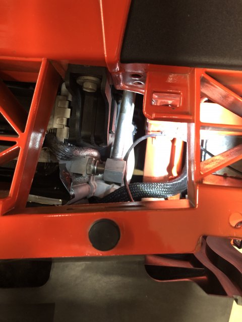

image.jpg On the subject of heat and manual transmissions and the blower inter cooler loop. I was under the impression the blower cooling loop heat exchanger (radiator) was in the sandwich in front of the main coolant radiator, it is but there’s actually 2 of them. Coolant comes out of the pump and goes to the small radiator in the lower left of the front facial, exits that radiator and enters another radiator which is right behind the AC condenser radiator which puts out allot of heat when in use but the weird thing is the manual transmission cooling lines go into the same radiator as the blower intercooler coolant goes into. Is the top part transmission fluid and the bottom part intercooler fluid?? Seems where it’s at and how its serving 2 different devices there room for improvement as far as getting the inter coolant temps lower if not using a power chiller??
I’ll be bypassing both radiators when the Chiller is active so it won’t hurt chilled water temps just putting it out there where it’s at and how it’s plumbed for “is there a better way?” And also a question of why engineers chose to do it the way they did? I can see why People who run the AC in hot climates have such higher coolant and IAT temps, the AC condenser is killing blower coolant temps.

View attachment 9907 On the subject of heat and manual transmissions and the blower inter cooler loop. I was under the impression the blower cooling loop heat exchanger (radiator) was in the sandwich in front of the main coolant radiator, it is but there’s actually 2 of them. Coolant comes out of the pump and goes to the small radiator in the lower left of the front facial, exits that radiator and enters another radiator which is right behind the AC condenser radiator which puts out allot of heat when in use but the weird thing is the manual transmission cooling lines go into the same radiator as the blower intercooler coolant goes into. Is the top part transmission fluid and the bottom part intercooler fluid?? Seems where it’s at and how its serving 2 different devices there room for improvement as far as getting the inter coolant temps lower if not using a power chiller??
I've never looked at it that closely but that is an interesting discovery. I'd mentioned this quite some time ago (either here or on that other site) that looking into using a form on external chemical intercooling could be hugely beneficial to reducing charge temps. That literally means spraying a mix of distilled water and isopropyl alcohol on there and letting the fan pull it across. I want to experiment with it in the Spring to see how much faster the Race Cool down function responds with the extra medium on the surface area of the heat exchanger.
