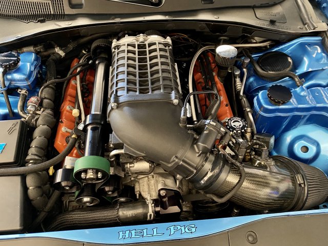

I understand the problems with a stock ported front bearing plate. I did this to mine 4 years ago before any shop was doing it. That's why I had to go to a Whipple. It put to much stress on the bearing plate and flexed the rotor's. I went with a billet aftermarket bearing plate this time. I'm still in the RND phase with this car. I agree the 3.8 Whipple will be the best S/C for an upgrade when they come out.
One thing about my setup it will never be just a race car / trailer car. I have way to much fun driving this 4 door sedan.
Hopefully the FAS bearing plate issues were a short term thing. One thing I know is those blowers don’t like RPM. We are seeing more and more come apart. As long as you aren’t WOT a lot, you might last a bit. It’s an all in setup for sure makes boost and also a lot of heat.

I'd re-route the TB connection to behind the air intake tube.
It has a zip on it. Ain’t going anywhere lol. Behind creates too much of a kink for my OCD. 😂

I haven't noticed your painted reservoirs until now.
I normally don't care for the look, but for whatever reason, I like the way yours came out.
Nice job!

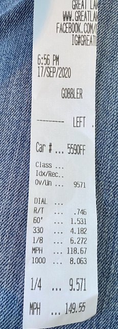

Good to meet you yesterday. Track was a shit show, but got one good run for data in. Can’t wait to get back.

Good results Brian. So...... rounding up, you ran 119mph in the 1/8 and 150mph in the 1/4. Stock 6.2 displacement with stock heads and at full weight with the un-ported version of the 2.65 Magnuson. On the first time out! ...... Hello 🤨
Thanks. Yes I’m impressed with pussy footing it out of the hole to grab a log. Tried one more pass and it was a no go, then more people broke. My tuner made some nice changes to the shifts that will send even better. Also found out we didn’t even hit its “peak” for timing on pump E.
Holy Crap
Fantastic results "right off the trailer " !

Holy Crap
Thanks. I would love to trailer it lol. This thing drives to and from always 👌
