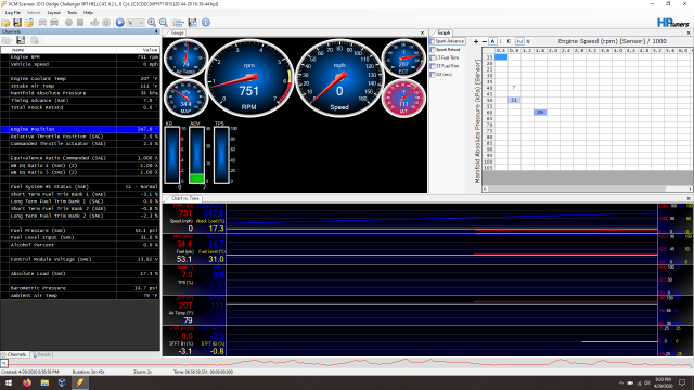

So I sat down with HP Tuners and redid my channels/pids. The channels/gauges/graphs from The Tuning School just didn't seem right when I went on a few spirited runs. It's back to basics and I'll add channels as I find a need. I watched Speedy's playlist and found his logging informative but not very useful for what someone would look at channel wise. If anyone has a config on how to turn the MAP sensor or a similar sensor to look like the Boost Pressure on the Evic/SRT Pages that would be appreciated. Getting mind melded when I compare that to the laptop in the car.

I must have missed it, I am subbed and never got an alert, for all those looking:

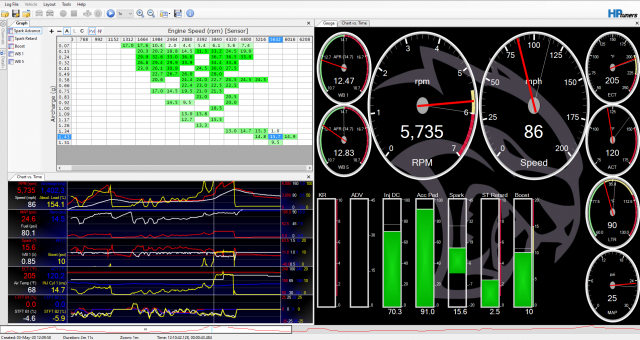

After watching the video and looking at the calibration file, I really have my UI setup so I can get to the data that I want. It's quit interesting on what I used to log with my Scat Pack vs what is important for Supercharged vehicle. Also spent some time playing with the gauges, charts and graphs to customize them to my liking. Even found a bug and submitted it to HP Tuners for fixing. Thank you for the video. Now to get all the juicy data and write a tune (maybe, one day...)

I just have the list curt sent me that I've tweaked to calculate actual boost and show the TRUE IAT2 temp on my car (cause there's actually about 5)...
The less channels you log the quicker and more accurate your logs will be. Only log what you need. Always tweak the polling times as needed.
Different people like to log different channels, so Ill leave what I particularly log out.
As far as using the MAP for a boost gauge of sorts, just change the units on the MAP to PSI, and subtract 14.7 from the reading (14.7 psi is atmospheric pressure at sea level) ie if you see 30 psi on the MAP youre at 14.3 psi boost pressure

Setting this up as a math and graphing it was one of the first things I did.
Base baro and MAP are both there. Simple.

Thanks...Yea I saw a vid where the polling was changed to speed up polling time. Just a couple of days ago I tracked down the Pressure/Temp sensors for the intake air. There's one just downstream of the air box (different type sensor looks like temp only), then behind the Throttle body on the 90 going into the supercharger, the next one is on the left side of the supercharger lid and the last two are the "Charge Air" one on the front of the right side inner cooler case and the other on the rear of the left side inner cooler case. Which one(s) are you using and what is the PID name(s) in the Channel Selection drop down? Have you got any idea how they relate to the instrument panel and uconnect gauges? Here is a link on the next line below hope you can see it https://www.hellcatforum.org/attachments/guid-2830047171-1-1-png.8709/
Cool/useful picture!
