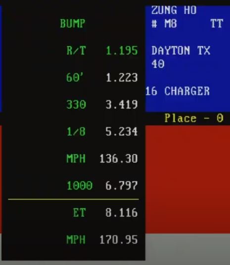

Just nuts... but good data to have on the rear end.
