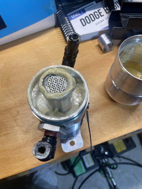

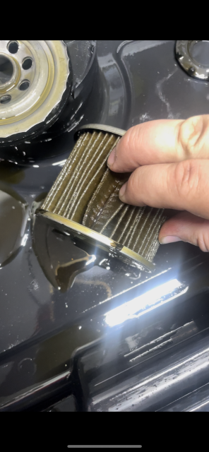

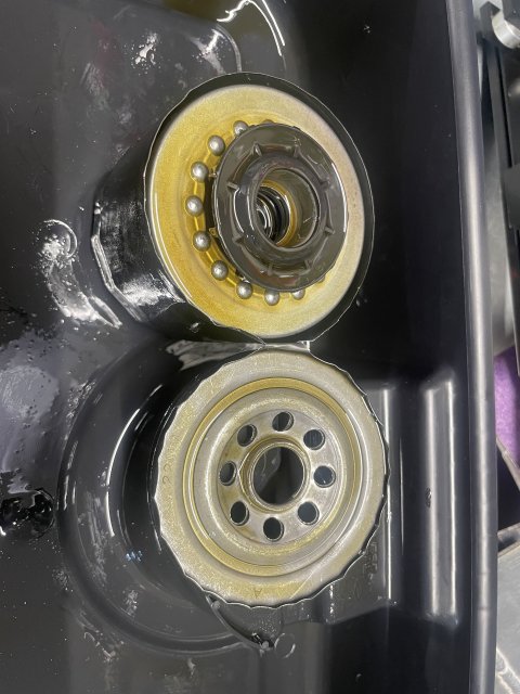

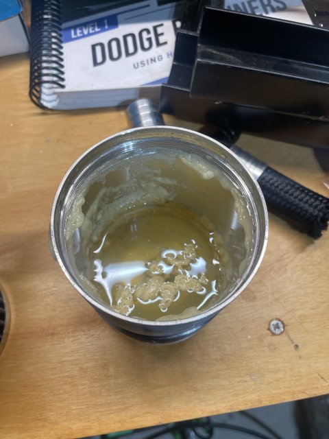

Results of the catch can and first oil change.
catch can cheese
moisture, e85 begone!
oil looked real good

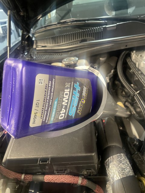

mmx wants me to run 10w-40 hps thats what im going to do.

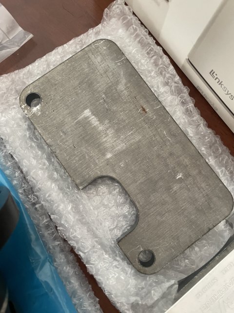

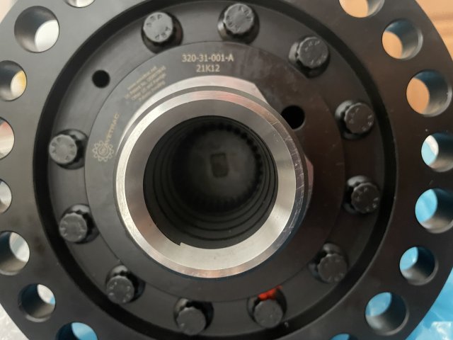

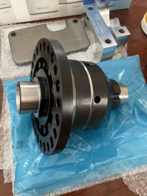

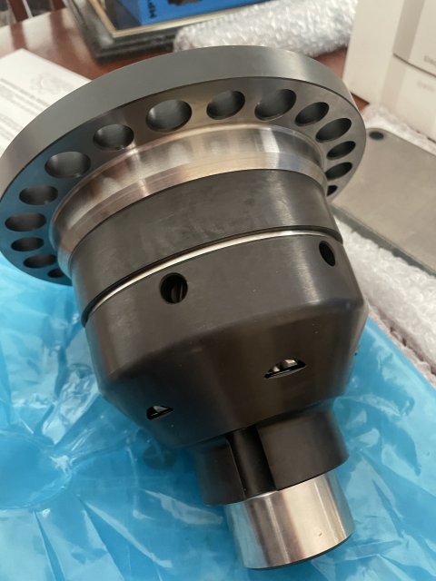

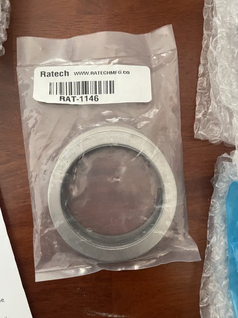

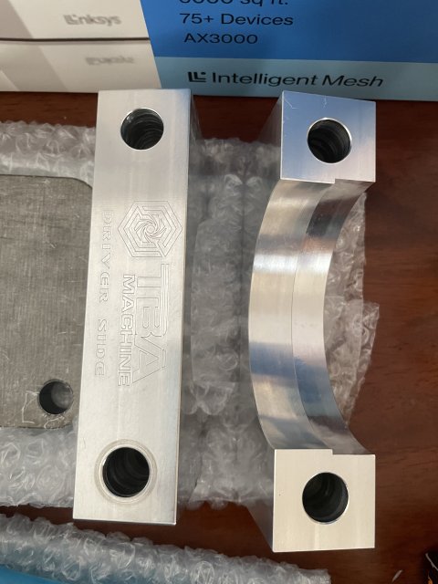

What is in the box when you buy a wavetrac and the installation it.
IMG_8817.jpeg IMG_8816.jpeg IMG_8815.jpeg IMG_8814.jpeg IMG_8813.jpeg IMG_8812.jpeg IMG_8808.jpeg IMG_8807.jpeg IMG_8809.jpeg IMG_8810.jpeg IMG_8811.jpeg
@Hatermkr assembled my 3.09 so I will be under his tutelage for this. Will also owe him cases of beer 🤣

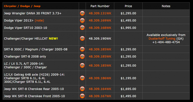

The only authorized seller is Dusterhoff tuning. I bought mine through HHP which then drop ships from Dusterhoff. Please reference the chart here:
Cost is as per HHP's site.

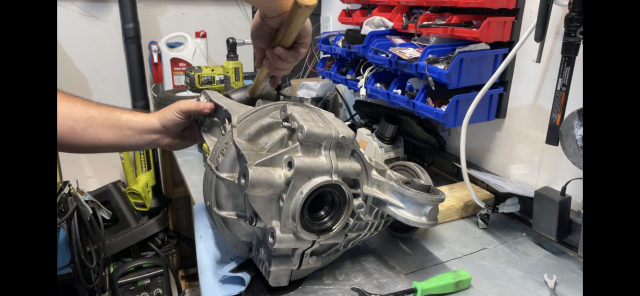

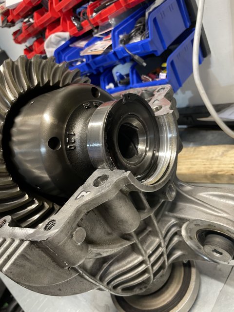

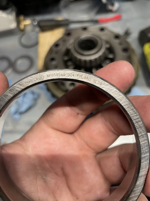

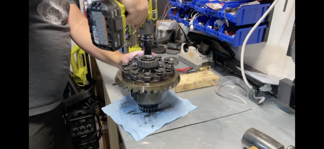

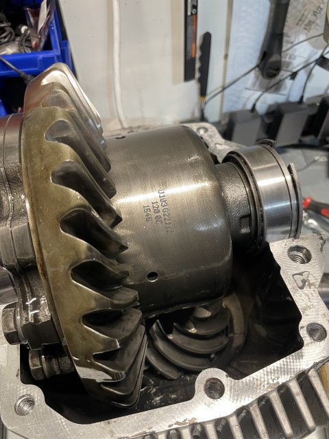

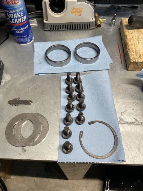

Okay so let diffapalooza begin. I have tons of video on teardown and will be posting them soon. However was disappointed in the diff that blew up at MIR could not be a candidate.
1. Take all bolts out AFTER draining the diff. Smack with mallet on ear and the cover will come right off.
2. Take out snap ring after removing rubber seals, discard seals and get new ones.
3. remove shims from left and right side. Carrier will shift as roller bearing and housing will separate.
4. remove carrier and place ring face down. Use an impact and a 19mm impact s
5. Clean bolts, bearing caps, snap ring and shims. You will not reuse bearing caps, and shims as new ones come in the kit.

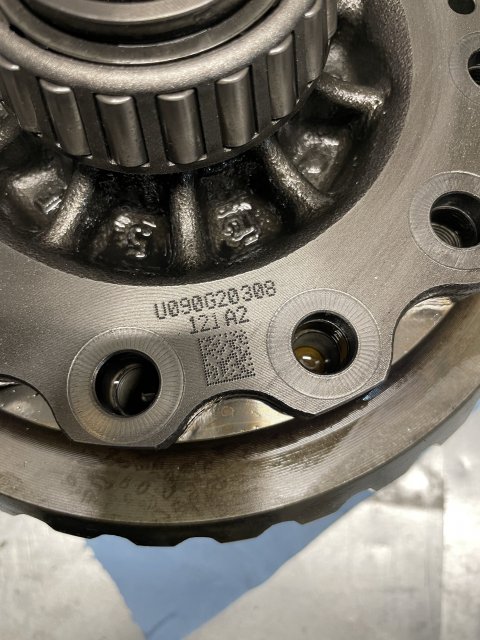

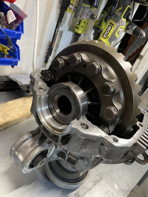

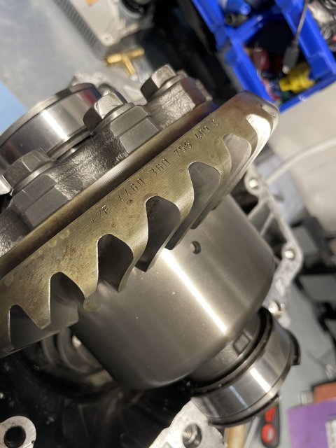

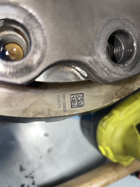

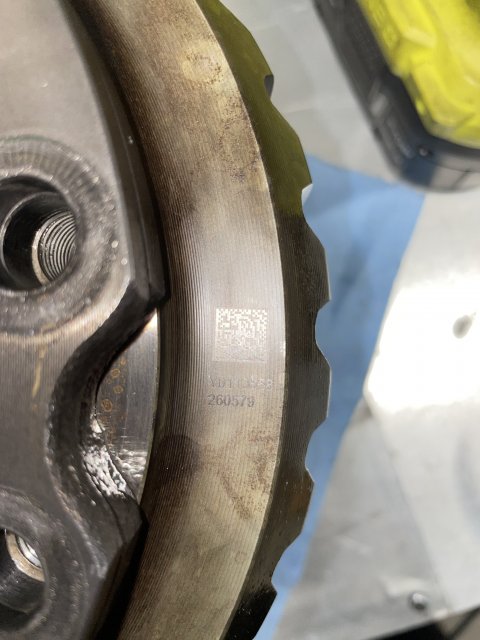

i took as many photos of serial numbers just in case someone wants to try and source parts
IMG_8843.jpeg IMG_8842.jpeg IMG_8840.jpeg IMG_8829.jpeg IMG_8829.jpeg IMG_8835.jpeg

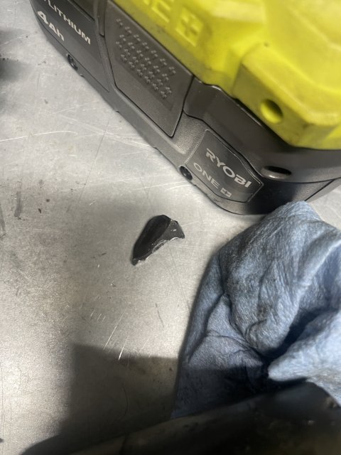

was really bummed that the rear bearing has shrapnel in it I can’t clean out. Stay tuned.

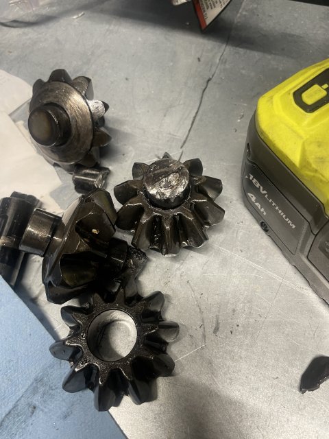

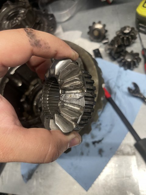

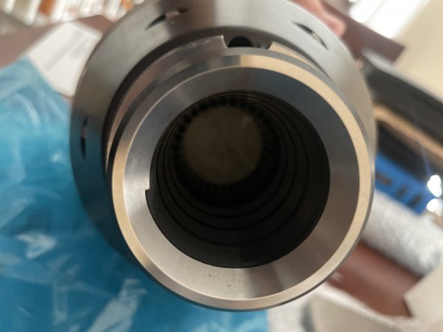

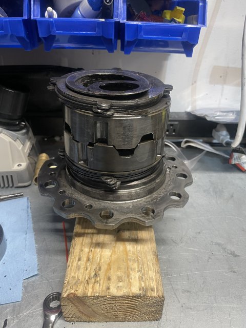

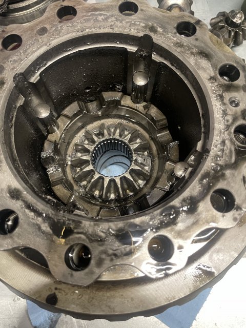

Weak design imo. i can see how the shafts between the spider gears make contact. The other internals are going to be meticulously cleaned and then 3d scanned. IMG_8859.jpeg IMG_8858.jpeg IMG_8857.jpeg IMG_8856.jpeg

Pardon my ignorance - so these ZF diffs are not a friction clutch style design?
4,117
10,339
Thread Starter #1,797
They are, here is the heap of garbage from ZF:
there was zero friction material on the clutches and the steels were scortched. This was a demon diff too. Wavetrac or bust. Once I get done with the teardown I will be doing 3d scanning of the hard parts and working with a well known clutch manufacturer to make clutches with better material. I however will no longer be running ZF materials. They are garbage.
