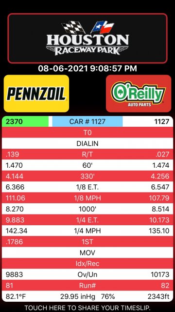

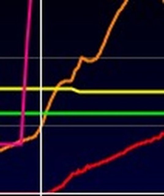

Trying for a 9, humidity is insane.

Nice pass !
We would be a very close race.
I went Friday night & ran about the same in a little worse DA & humidity.
My first pass I didn't get a slip so had to go to the tower to get the #'s but it was 10.18 with 1.48 60'.

Mph is there. Work the 60' and you'll have it!

So close but yet so far away, it’s coming 👍👍👍👍
