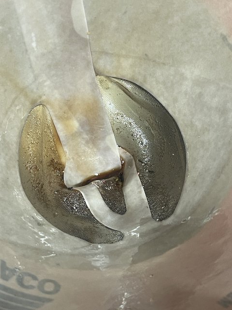

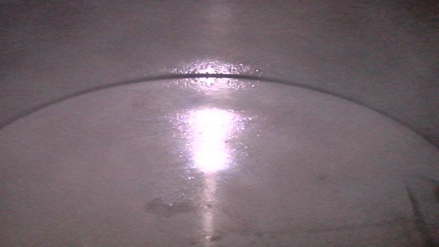

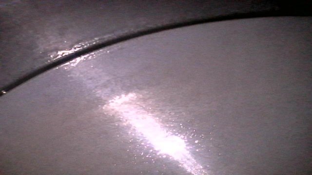

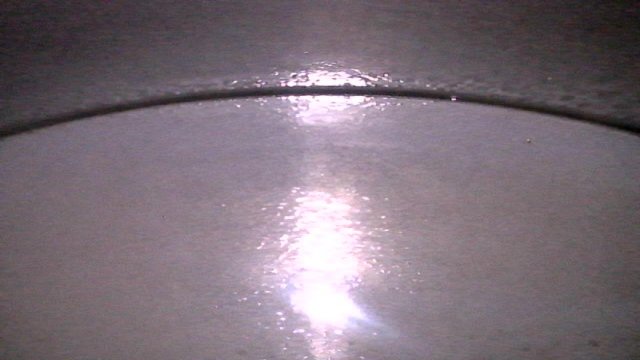

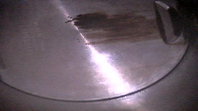

Cylinders 2,4,6,8 no longer have pools of oil on them. IMG_8068.jpeg IMG_8071.jpeg IMG_8076.jpeg IMG_8081.jpeg
#2 still has some cleanup to do but with time…

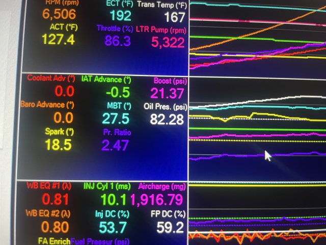

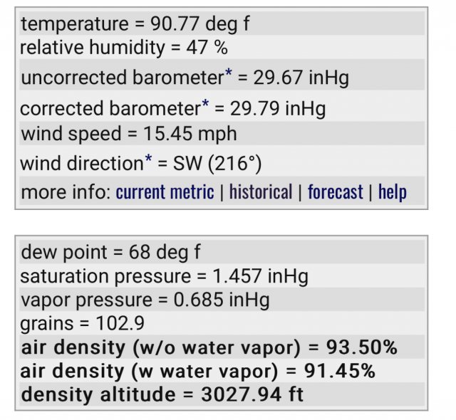

In 3000 DA made about 21psi of boost and almost shit myself.

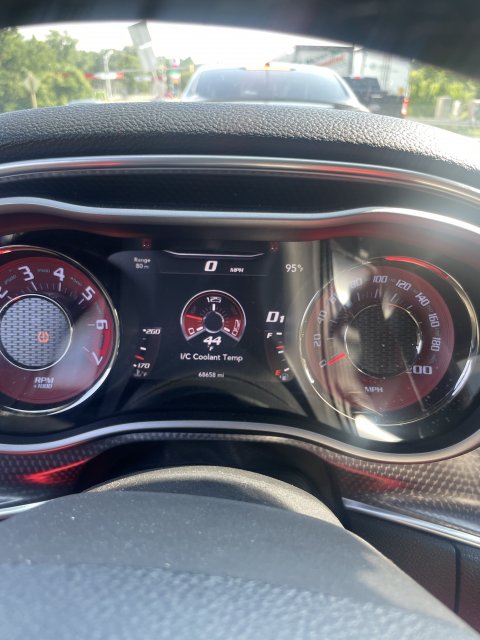

almost out of the woods. Now the problem is how to get the IC chiller temps colder faster. Might extract one gallon and replace with distilled water and see how fast it gets down. On 94* theres only so much you can do with the stock coolant as it fights

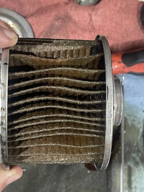

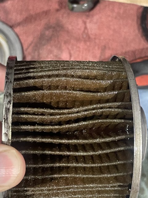

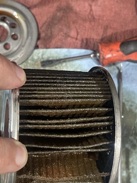

Also we cracked open the oil filter and we also ran the break in oil through a filter
for break in oil this is expected.
Are they flakes or reflections?

Don’t sell the car. Send it man, glad things are looking better. 45 seems good, is that with drag valve on? How long did it take to get them that cool?

Cylinders 2,4,6,8 no longer have pools of oil on them. View attachment 110272 View attachment 110273 View attachment 110274 View attachment 110275

Your car is still pulling timing even with the chiller? Interesting
Both this is expected also little pieces of rtv from the front seal as you install the timing cover on a new motor
Drag valve on, too long about five minutes.
I mean what do you expect look at the iats, we pulled a vacuum and refilled system. It gets colder faster, but still not fast enough going to start adding distilled water and see how it does.

Will get iats cooler faster as chiller will be more efficient

With yesterdays humidity and heat that is actually very impressive. 51 degrees below ambient. That system is cooling more than effectively.
That’s intercooler temps not IAT. I hate that no one shows IAT
8,552
7,499
IAT will only ever be 5-10 degrees below ambient with a chiller
I always show iats and they were 75 degrees cruising on the highway. Keep in mind the only way the 2.4 gets cooling is passively. Without large volumes of air it will always be hot. When I hit wot they went down to 60.
