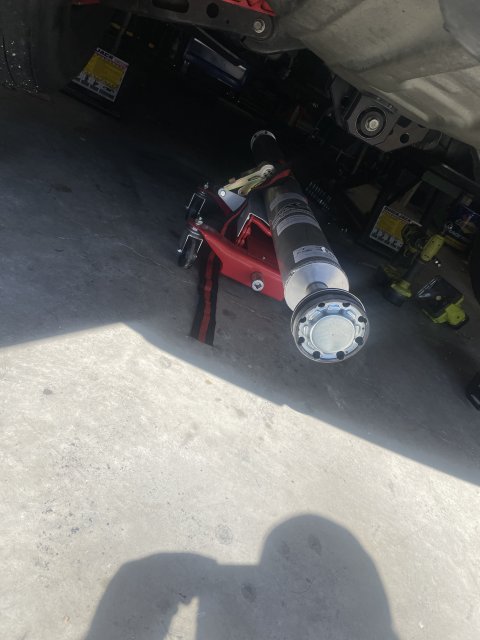

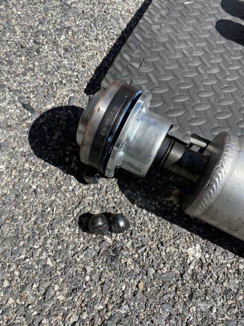

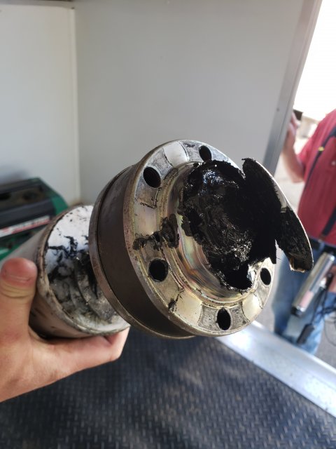

View attachment 99880 View attachment 99881 View attachment 99882

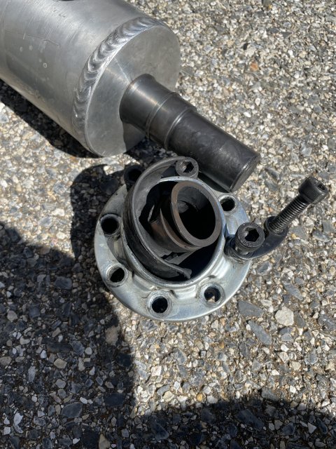

Front and rear broke. She was sent. I have a copy of the obituary:
Today we pay remembrance to my DSS one-piece. Born September 29th to @fumanchu182 and @HighHorseman . A resident of MIR, Cecil and Capitol, the drive shaft is survived by a 2015 Hellcat, 2016 Dodge ram and the drive shaft shop. The driveshaft was a ardent supporter of burnouts and quarter mile passes for three race seasons. Viewing services will be available till 3/13 when recycling will collect. 🫡 🇺🇸​
However super easy install. The hoop was damaged so ill be ordering another one soon. Better it than my undercarriage.

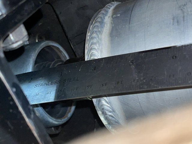

View attachment 99885 View attachment 99886
3.5 inches from edge to edge, fully in spec.
Only way it would be out of measurement would be if they made it wrong. So they want you to check their work:unsure:

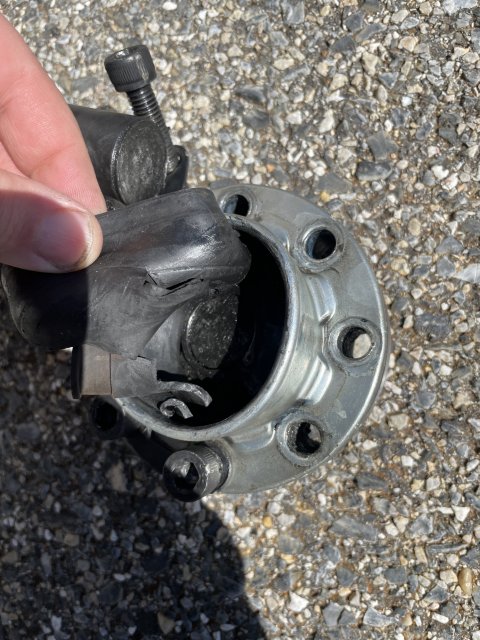

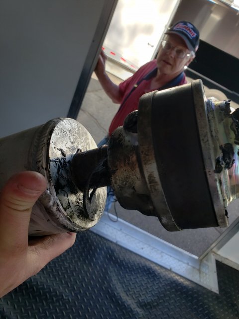

This is the one Jon and I swapped out at the track for another racer last year
8,741
7,675
Junk. I’ll never own a 1 piece again unless it’s a wiles
Just put a new boot on it. Junk

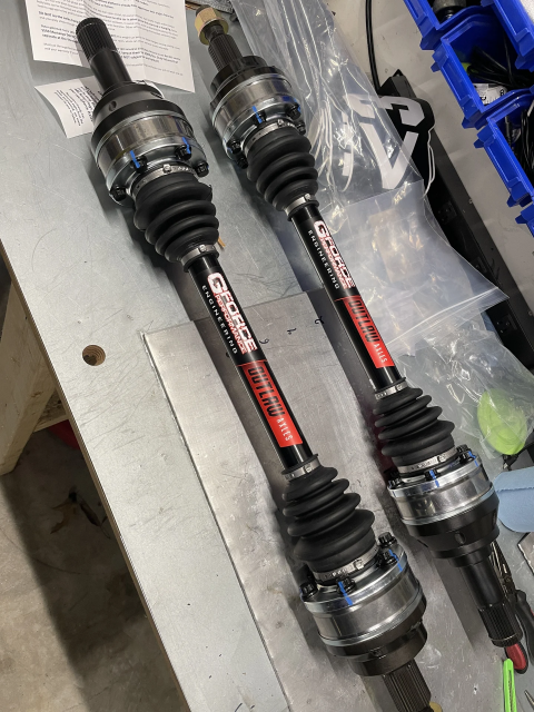

Checked the logs, everything is good, got out of it at 22mph/6200 rpm, engine didn't spin past that so not going to worry about the trans. Axles are still in and they will enjoy every fucking second of beatings I give them and then when they go. The bigguns are on deck..
Nice. What driveshaft are you putting back in the car?
Ummmmm... Scroll up 🤣
