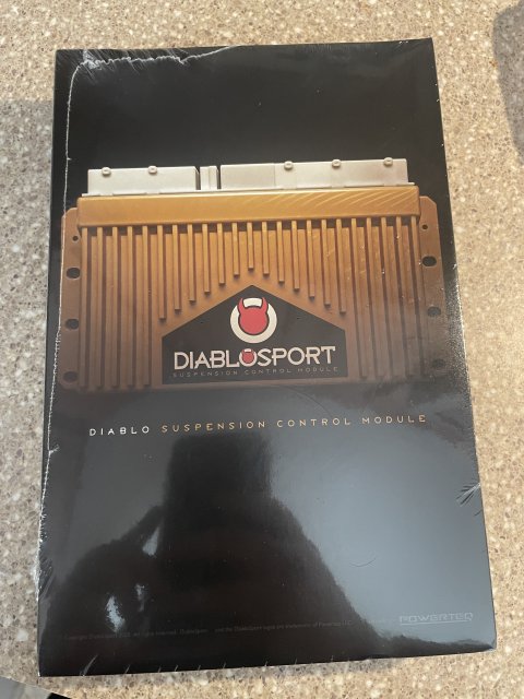

So on this is track mode for suspension what you want for drag racing? I’ve never been sure never really looked into it
4,117
10,339
Thread Starter #1,115
So long story short this is a private labelled DSC controller. Diablo Sport worked with DSC to dial in calibration files for drag racing. If you get the DSC controller it will be more geared towards twisty roads. It is programmable with Diablo’s software, not DSCs.
I knew they were one and the same. Just branded different. Good to know about the why Diablo put the brand on it. so essentially drag became track. For my car 2019 chiller only works in track maybe I should have tried this before the ice tank. O well to late now

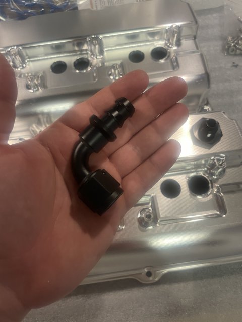

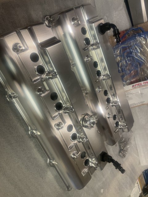

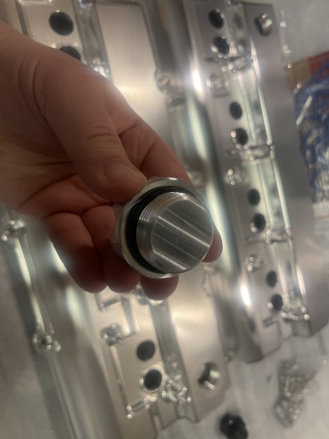

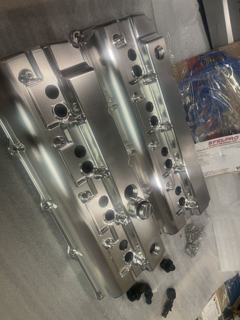

I love it when a plan comes together. These just arrived.
1C74ED6B-8FBC-4A70-8322-B96AB8E5FB7A.jpeg E25716DB-567F-48F3-AA79-A867AC7E4434.jpeg C8F4D822-261C-47F6-A09E-1593DCE8E4B1.jpeg 61B43E77-8298-46F3-A296-F2A3AA44267C.jpeg 28AA20D0-465C-4282-BBCD-5952230A7998.jpeg

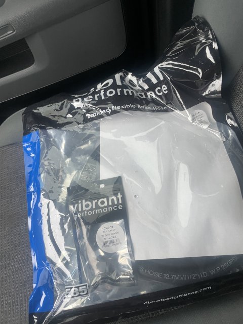

purchased separately from Vibrant
12 orb to -8 an for the vents. The current JLT cans use 1/2” line. So I picked up a few -8 an fittings and hose. Helps a vibrant warehouse is two miles away and the guys like your hellcat.
i need some motivation to get this done :)
7,485
19,670
How do they help with plug changes?
4,117
10,339
Thread Starter #1,120
all the space… No goofy ass un-needed baffles.
