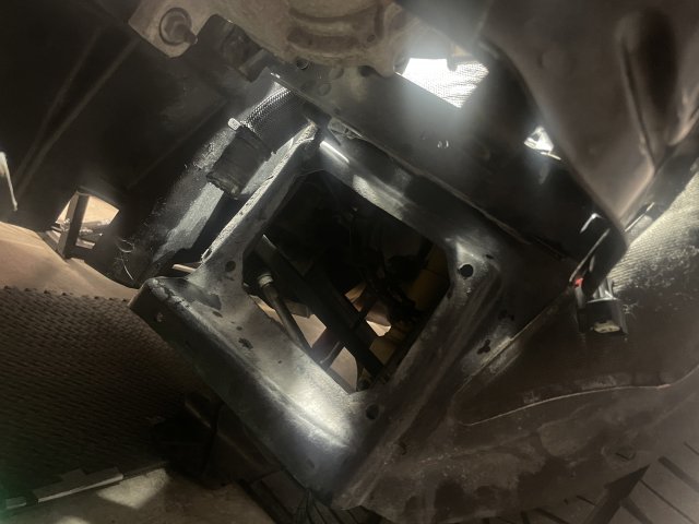

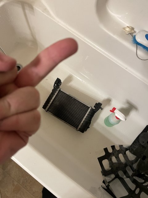

Install tutorial starts right now. Step 1 remove the lower temperature radiator.

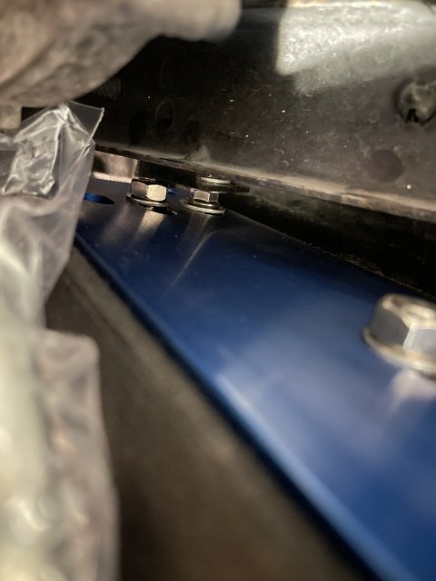

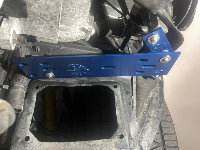

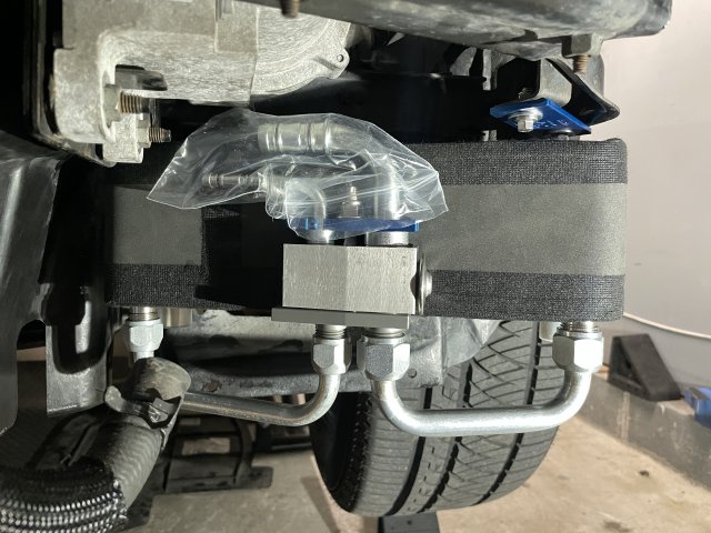

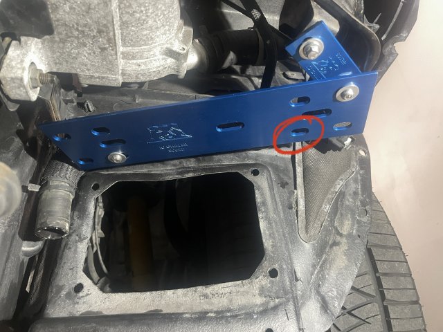

Step 2 install support brackets for chiller. Tools required: 8mm, 10mm and 13mm sockets or wrenches. Swearing optional. Start with the smaller bracket, leave some what loose til final tightening sequence.
Attach cross bracket, take note of logo placement and holes the bolts are placed in.

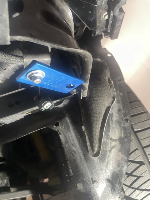

My tightening sequence was rear bolt, front bolt, connector bolt. Attach chiller brick from below and start the middle nut.
the rear nut was the biggest pain in the ass to get started and tight. This is where swearing is recommended. I created a new one: dildo-headed-cock-fucker.
I have attached LTR removal instructions from the FSM.
View attachment 93244 View attachment 93245
Does the LTR go back in?
No, permanently gone. The IC system is an always on system. With the KC I could have gone this route as well but choose not to. I regret that decision, it was like trying to stuff 20 lbs of shit in a 5lb bag with the limited room.

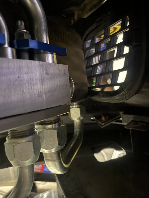

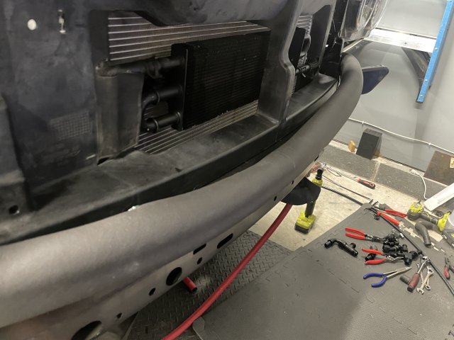

All righty did a test fit with the bumper and cursing worse than given watch right before a shore visit...
Try number three
Absolutely seething at this point, texted @RGPIII that I might not run a bumper. Stepped back, meditated for ten minutes. Found my fucking zen...
Mounted on the above hole and wouldn't you fucking guess it.

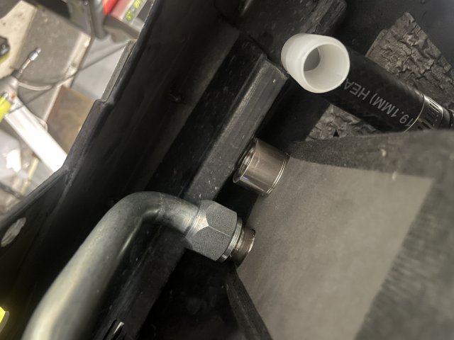

While under here decided to mock up hoses and index the inlet port.
Did one final sanity check to make sure the AC fittings would get past the pump.

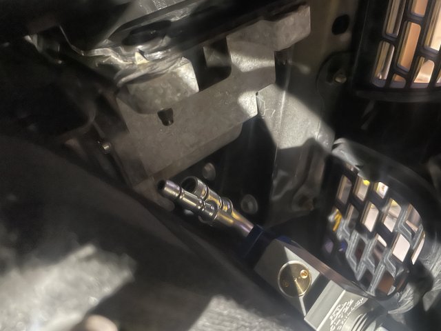

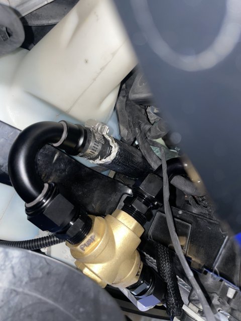

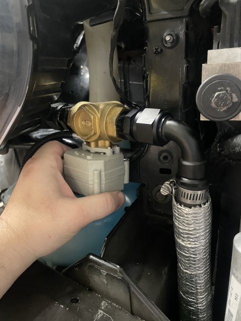

Hope this helps anyone from having a fitment issue. Moved onto the 3 way bypass. Since IC Chiller is always on the default is to send it right back to the pump. However for winter driving the IC system reverses the main SC condensers flow naturally it is exiting here but we are changing that.
The above is the SC outlet routed to the bypass.

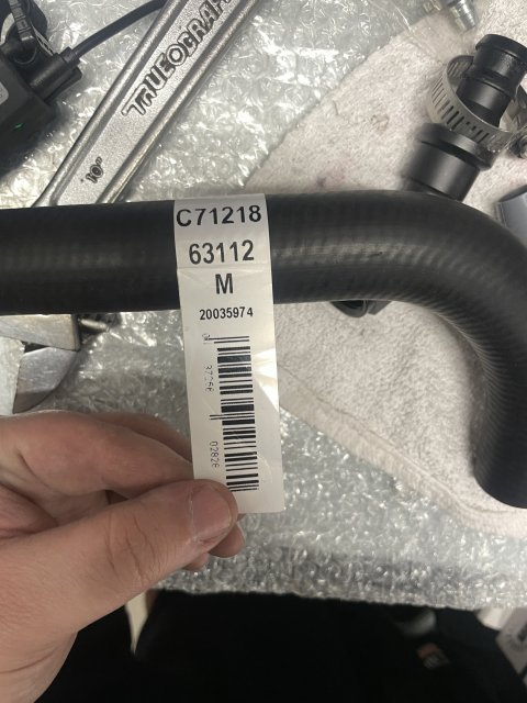

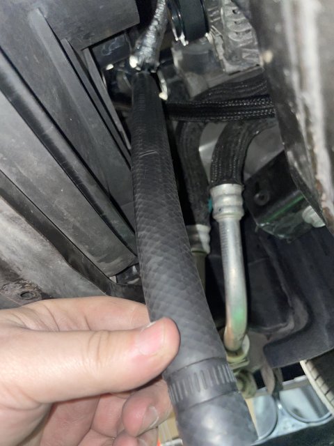

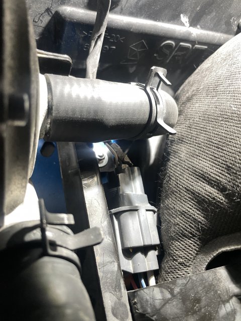

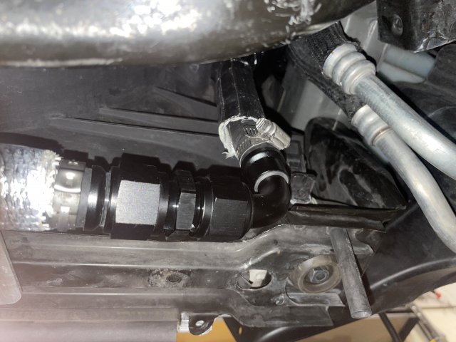

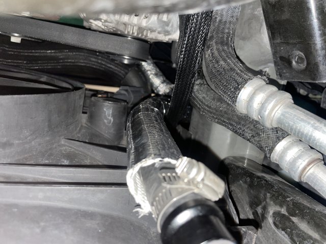

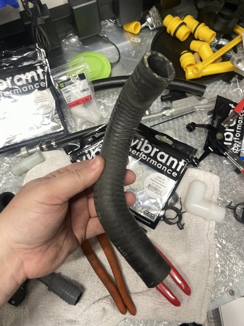

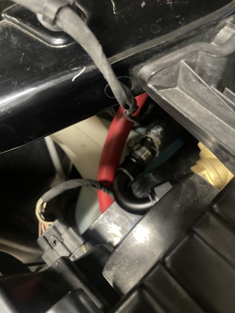

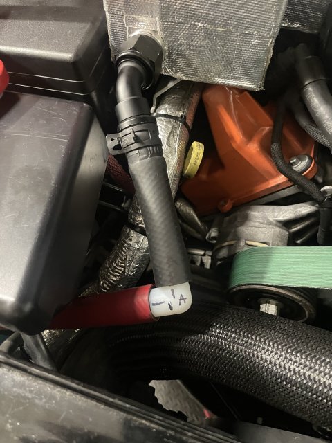

Some progress, trials and tribulations. First off Fuck Dodge in all holes with dirty syringes. This hose is from the back of the coolant pump.

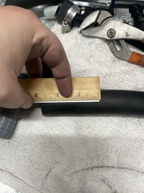

It necks from 1" to 7/8 instead of 3/4. Trying to get a pushlock to work was insanity. Solution was this hose.
Cut this much off from the long end. 2.75"
Afterwards easy day.
Use a 1" to 3/4 reducer and a 3/4 hose elbow.

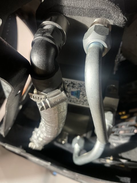

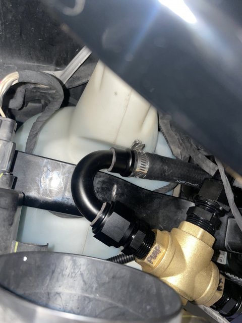

Them on the 3 way great progress with the 150* fitting.
Dumps down beautifully.
Will be adding the final AN pushlocks soon. More to come!

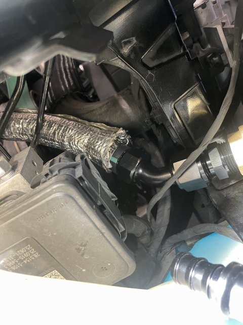

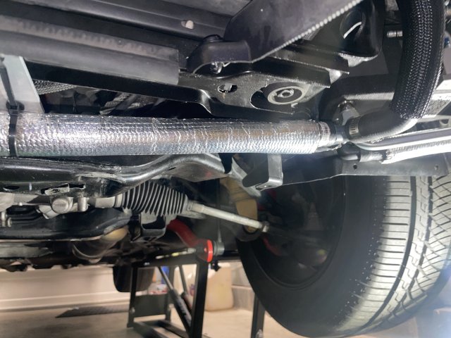

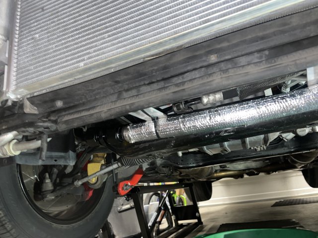

ran some vibrant extremewrap 5EB52F82-9E92-4927-8F76-ABCEE72DD750.jpeg 38CAECA9-CA55-4A9D-865B-BE2747287CBE.jpeg

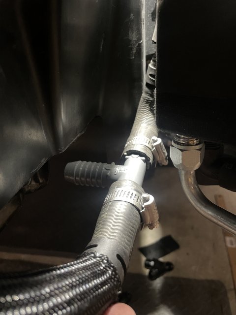

The above is my drain point, 12an union. EF55274F-F31A-4B6F-8246-B9FA3E13EA3F.jpeg

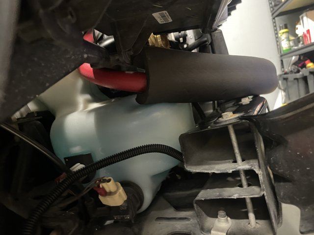

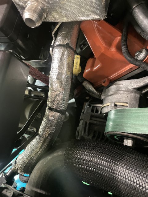

Neatly tucked if I do say so myself. 71323B03-C8DF-4F72-A9AC-2BAF55DD7711.jpeg 3F987E0E-3531-45EC-8875-82F8C1CC4282.jpeg

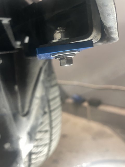

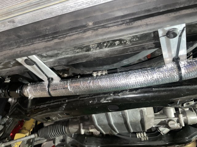

Started running the IC exit to the bmr tank 08B36DC5-90B9-4001-A084-5B71D49E3810.jpeg
for the more cramped spaces I need some more vibrant wrap but ran out :( this might be a monday thing as the speed shop is closed
