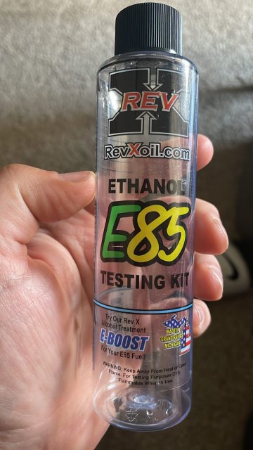

It’s time. Picking up three jugs this evening.
4,385
10,906
4,104
10,288
Thread Starter #679

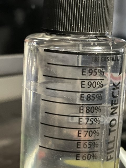

Got about 15 gallons. Testing e82.5?
60,672
211,582
about where mine has been. This week it was 85% though. I have only been using one station that is just down the road from the house
