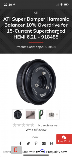

e85 is next, been studying for that tune. Would you recommend this overdrive?

Thats the one I have been running on my car.
With a 2.72 Hellraiser and the 10% overdrive, would you have a guestimate on what the size would be? I know you run a different S/C but if you had a guess?

The ATI 10% overdrive lower adds about 3psi of boost.

Im sorry I meant to elaborate on belt size. Damn iPhones. @Tuckerracing

K100594HD i believe is the belt number for Litens 2.72 and ATI 10% lower

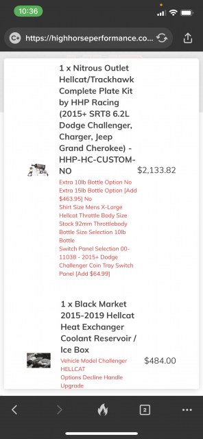

For anything over a 100 shot the professionals will be called in. Spoke with HHP about the kit and we walked through what the setup would be.

Okay cancelled the nitrous, someone came by and did this…
spoke with hhp again, said just run a 10% overdrive, catless and q16. This is the way.
