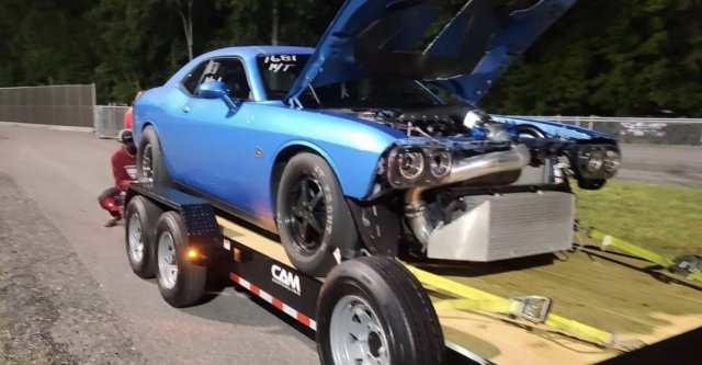

Is that Big Chief ? :LOL:

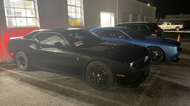

At the shop, getting my new rear tires put on and then the skinnies as well. Hes waiting for the tuner to arrive while im changing trans shift pressures. We are going to be doing all the sends, lets gooooo!

The turbo shall forever be known as Big Chief!

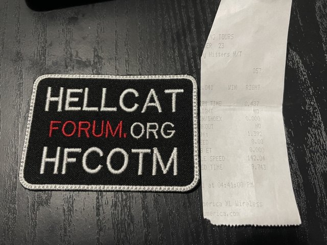

However this is boost weather, me and the gang went to Capitol. I had a chance to really test my tuning capabilities for the TCM. Hard work and persistence paid off:
60ft: 1.392
9.743@142.04
Thank you @Hunter for the awesome patch! Today was a great day!

Geez you have came a long ways! Remember when you were mad because you couldn’t get 9s?

Congrats, she was on a pass, very nice !
But man that mph seems off on the 10.04 pass, you run a 10.04 @ 119.04 & the other guy runs a 10.74 @ 119.91 ? ...we know 1/4 mph is way higher than that.
You had 10mph on him at the 1/8th & he had more than you at the 1/4 ??
Something off with that but the et looks good.

I do and I look back and reflect, going forward just remembering to be patient. I had an offer for 60k for the car and I almost took it. Look at me now, cheesing all the way to the 1320. 😁
I was on the brakes. Look at my 1000’ compared to his. The car was eating!

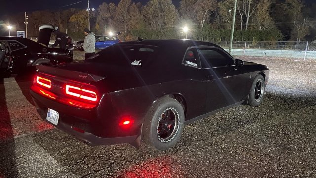

DE8230FD-0DEA-448D-8109-24A30F123CD3.jpeg The D5 fronts complete the look and the Mickey Thompsons drove beautifully.

Oh ok, so that was his actual mph & on the brakes for you, makes more sense now.

How did those skinnie tires do on the street, assuming you drove to track on them ?
What tire pressure are you running in them ? strip & street ?
3,935
9,719
Thread Starter #395
They drove just fine, as with even the S/R don't take turns fast and don't brake hard, with skinnies on I tend to do the speed limit more in the right lane. 50PSI as per Mickey's site to get the correct load rating. It was cold so they dropped to 44, but on the way back home tonight bumped them back to 50. What makes me happy is they have a TPMS in them so the lest shit I have to deal with my god awful Tazer the better.
5,176
9,642
Yeah I saw M/T site say 50 psi max, wasn't sure if you would run them lower than that, when driving on the road they will rise in psi but not sure how much ?
My buddy called M/T about that tire & they told him the load rating was too low for the HC weight in the front, but if they work that's good.

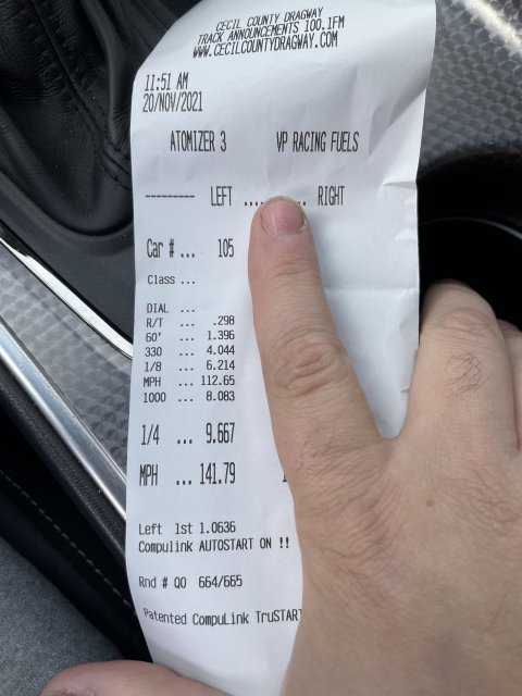

My go pro is straight garbage but my friend got a video of that 1.392 60’.

Going to look at getting a cage soon. Repping mopar hard. Blew the Camaro the fuck out the water. Going to have to hit the brakes hard in the 10.00 class or switch to my 93 tune.
6,915
17,838
See, we told you once you got good air it was easy 9s in that car! Rather than switch to a 93 tune, just lower the timing a bit (-3deg ish) in the E85 tune and lower the shift points a few 100 rpm and you can slow it down.
Be sure you want a cage. Once one goes in it's more race car that street car. Rattle rattle rattle.
