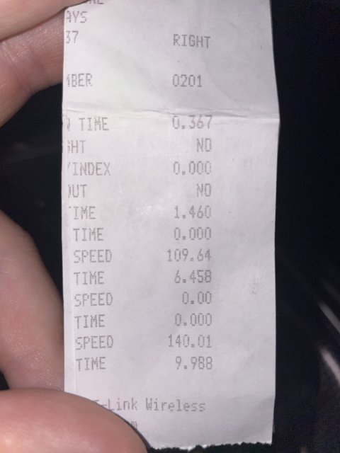

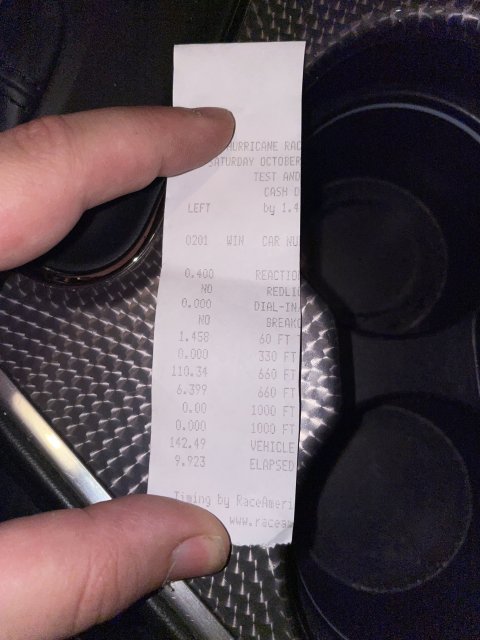

She is dialed in. The 60’ was the plan for tonight. I love pro tree. They were running a .500 tonight. Last run had a great 60ft. Track was sticky! So sticky a drive shaft came out and hit a guy. ;(
I think Im on point to be a 10.00 car for the mhsh. Ill put the seat back in or add gas 🤣

Man your local track is really prolly getting to know you. Every weekend it seems like. Good work. Have to feel good to pull out so many 9 second passes.
If 9s were easy everyone would be doing it.
Have you put any thoughts on what you’d have to do to run 8s? I have. I need a short block 😂

Now you Got It
Thats a great 60.
Are you running MS109? Or What?

You know, I'm almost wondering if your track has the 1/4 mile timer off a couple feet. Those are really good 60' and the MPH as well. That would be a high 9.7x in my car at my local track. My 1/8 mile times are a hair better, but all this time it could have been where those timers were set.
P.S. You can't tease me about my pro tree RT anymore though LOL

Hard to say. Remember we had almost identical time slips and I had 1mph more and you went 2 tenths faster.
I wish had that log still to know but I’m sure there was knock. For whatever reason In the log I double clicked record and didn’t notice so I didn’t get the pass.
regardless he is moving with that mph.
But I do agree with that 60ft and mph his et should be better

Hahaha, yes I can, I usually cut .1 on the pro tree. Anyway the logs never lie. I think I'm hitting torque management issues finally. I am doing a deeper dive but right now in the logs either the ETC A/B kicked in and said you are making way to much torque, close TB or I banged off the rev limiter, which not going to lie, it felt like it was falling over from 1-2, just not a hard shift. I am going to do a deep dive in the current revision and see what I have set for those limits. If the OSS speed is not set high enough, I'm going to raise it a smidge to move it out of the way and Torque MGMT be damned!
