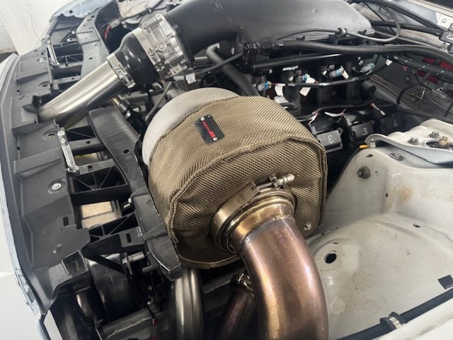

Final pieces falling in.
4,117
10,340
Thread Starter #850
It has been a mad scramble, but it has all finally come full circle.
First passes 10.9 @ 127mph on 3psi #2step #dragracing
It was not a day to go full nutters or set the world on fire. It was a day to Test AND Tune. Learned the following.
1. Need bigger radiator and fan
2. Need bigger trans cooler or relocate it. Might fab a front mount. Under car has a lack of airflow
3. Car does not require a lot of power to go fast.
4. Holley is stupid easy to tune and I love the platform
5. Havent done this since 2023, I feel whole again
