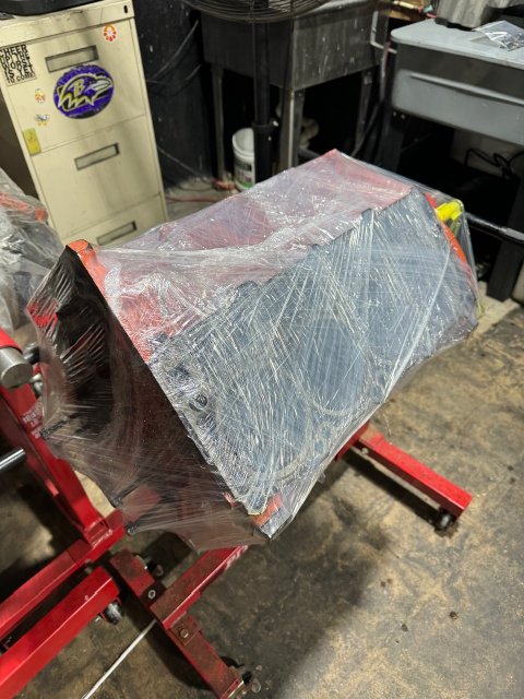

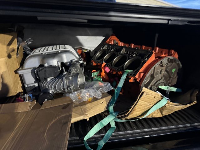

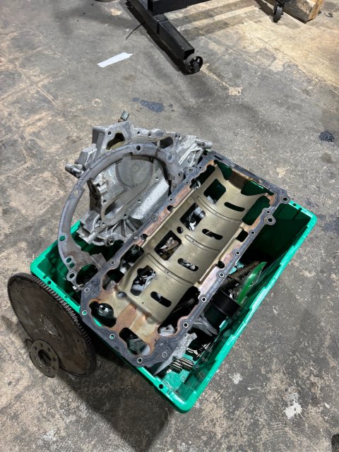

Machine shop special. They had a block that they were looking to move. I have a need for a block for a build in fall of 2024. Came out of a 2019 Charger that was in an accident, customer lost interest in project, machine shop sold on customers behalf. Some of the parts will go right on the OG build for my charger. IMG_0797.jpeg IMG_0798.jpeg IMG_0796.jpeg IMG_0795.jpeg IMG_0794.jpeg

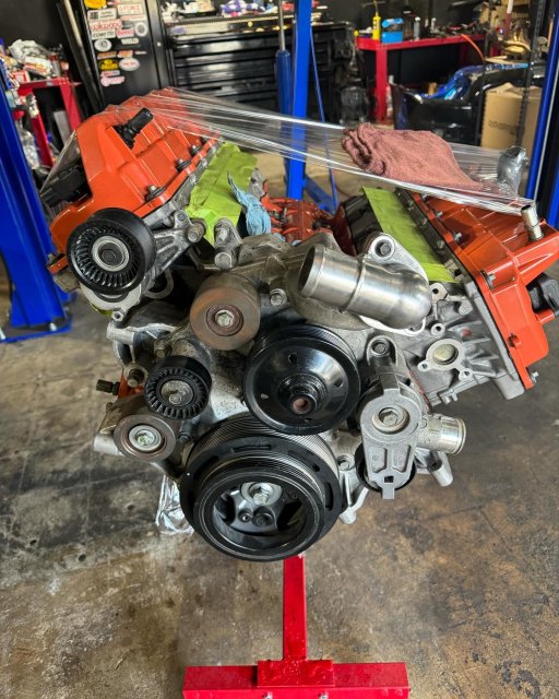

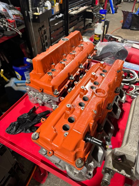

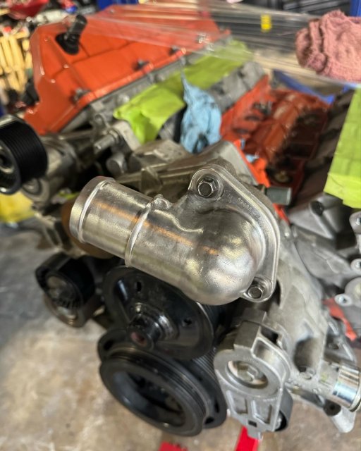

Spent the weekend learning how to assemble a long block. This is the OG block from my Hellcat. She’ll do just fine on 15psi to start with.

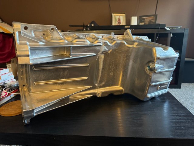

I thought the new ones had the hellcat logo on them?
The ones with the hellcat logo are 2018+, I wanted one as they will fit and the oil pickup clears. However on national backorder. The one I have is a factory correct 2015-2017 but was available from @HighHorseman who had it in stock.
