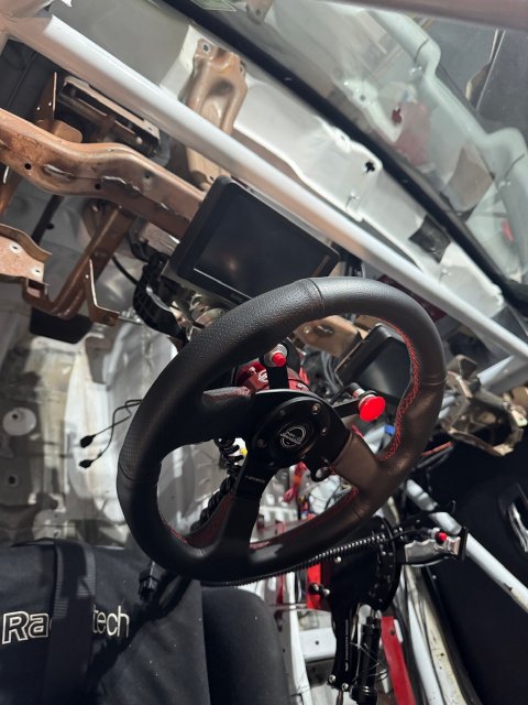

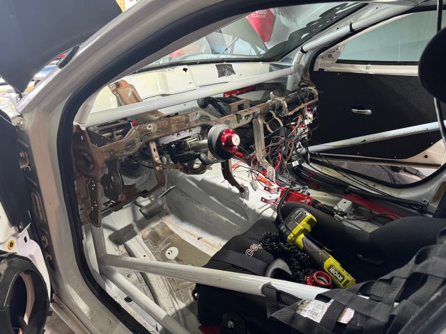

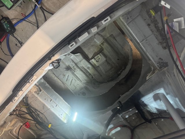

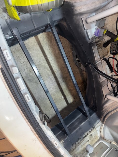

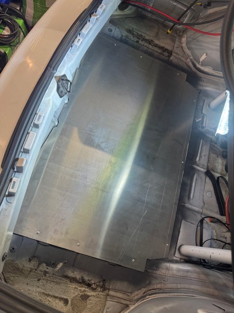

Fully have been Mia, just no energy to do anything till one day I got a bug up my ass. Started tearing car apart again.
IMG_6623.jpeg IMG_6629.jpeg IMG_6630.jpeg IMG_6612.jpeg IMG_6614.jpeg IMG_6617.jpeg IMG_6636.jpeg IMG_6637.jpeg IMG_6641.jpeg IMG_6642.jpeg
working on re routing lines, making the trunk safe and the electronics are getting revamped, learned a lot and taking my sweet ass time this time

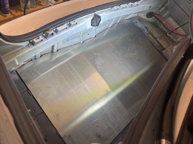

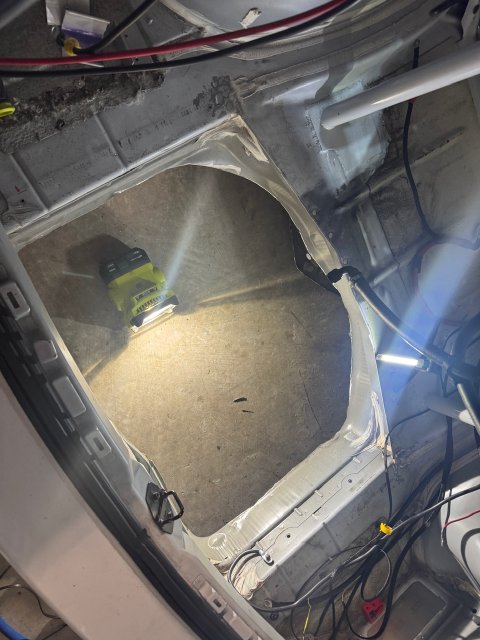

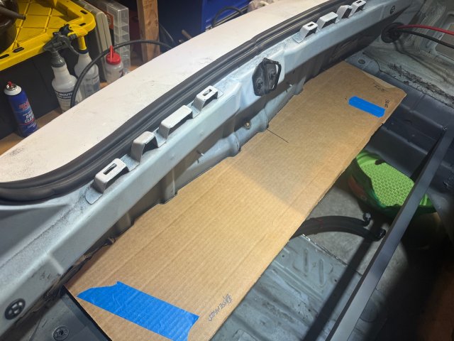

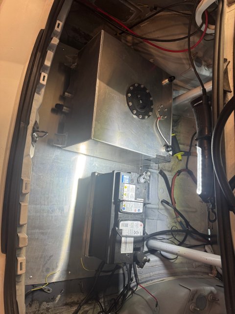

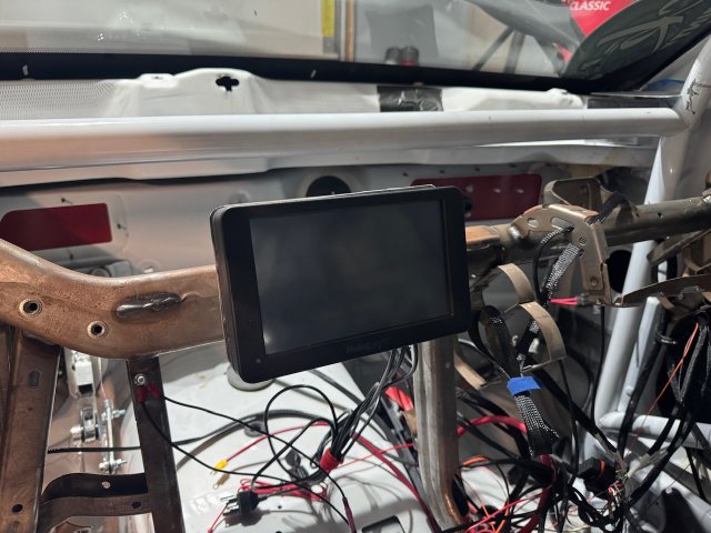

Thread Starter #740
Had to change config but way happier. Also taking my time and doing it right.
will have more photos of the underside soon. Have to fab a drop plate for the pump.
