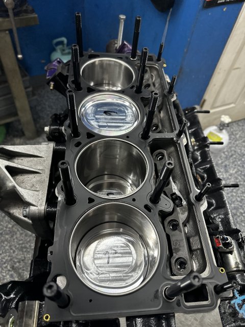

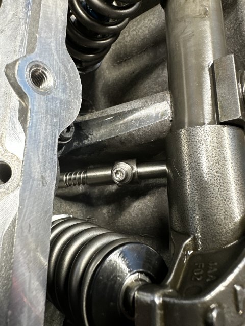

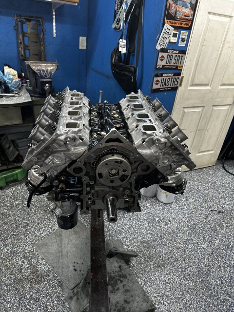

71080641161__D7283DA0-A564-4038-B14B-7E7CC1DD31A3.jpeg 71080344756__11824700-353F-4CD0-92A7-5BCF8F049491.jpeg 71080562001__AE15C48B-15AC-47FD-A317-A65F9D3F82DB.jpeg
should be back on cradle in the next day. Had to have push rods made. Trevor at Manton push rods. Had them made and shipped in hours for us. And hooked up on the cost.
