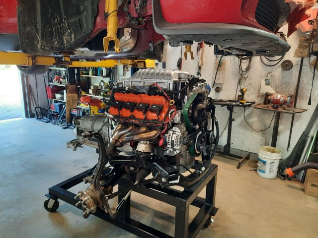

you guys need to build one of these an roll around easy as a grocery cart.

do you have dimensions, that's a nice welding project i'd like to undertake.

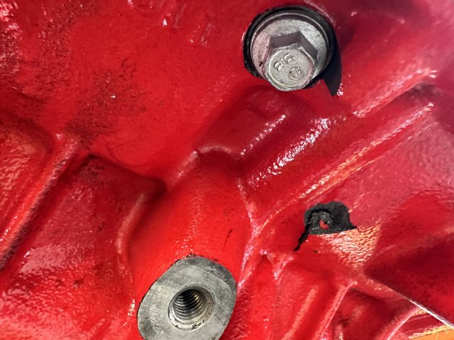

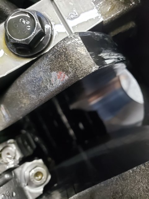

I can't believe there was no hole in the block.
For what? Dolly for the cradle/trans?
That means it’s still good!

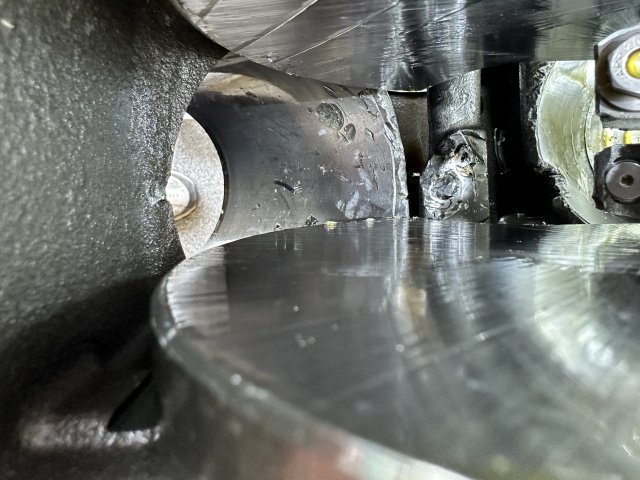

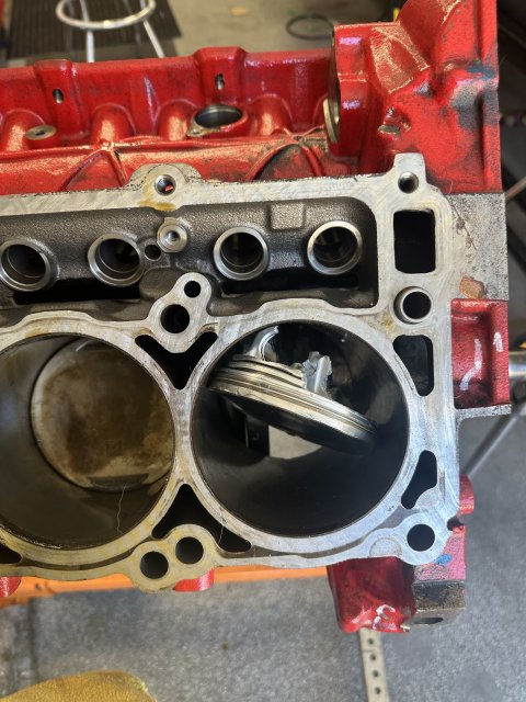

May have been hard to see but took out some of the cylinder 20230708_132926.jpg
Hell I’d drop the engine to change the plugs if I had that
look up ( hemi dolly) thread posted by DemonSRT back to Dec 23TH 2021.......lots of pics an measurements. its Demon SRTs design, I welded it all together.

Can’t with the oil galley missing where the piston squirters go
Sell a self weld kit
no, but there`s a good pic of all the pieces in that old thread an all measurements. the steel supplier cut all the angles which made it real easy to square an weld.
