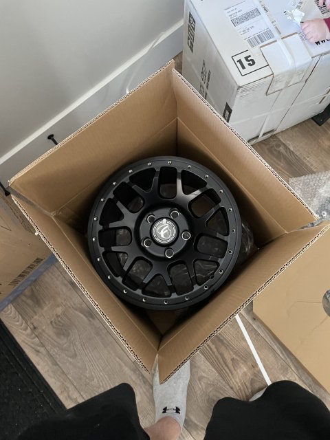

New wheels for car trailer so they match the car:geek:
hahah that man putting bead lock on the trailer!! shewwiee that's how you know its a race car!!
59,751
208,123
They are just some small 15s with a beauty ring that bolts on for looks. :)

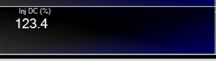

I am just now looking at the log from the 156mph run. Well it could have been faster but at 137mph this happened.o_O Pass 1 when the car cut out fuel pressure dropped but not much. So one of two things happened. I am having a battery issue and the bap couldnt give me the 22v or the pumps died. Lckily car never went leaner than .92

Eek
Holy crap

shouldn’t the bypass valve have opened around 90% Inj DC to save the day?

Have seen on a few cars doesn’t always work

Oem broke that functionality for model years 2018-2021 Hellcats and Hellcat variants. For 2022, it seems to have started working again.
