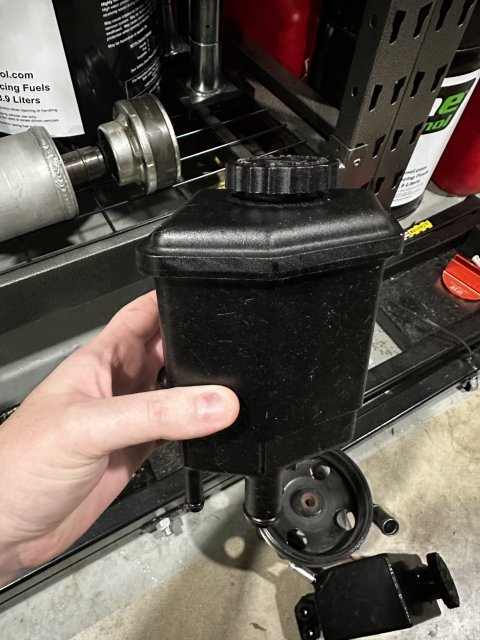

I made a remote reservoir so I have a plastic one if you need
Wish I knew that lol had to buy an entire new pump when got rid of the whipple because metal tank wouldn’t clear supercharger intakes lol

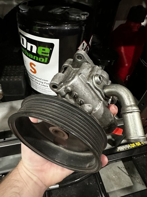

I appreciate it guys. Luckily I have a spare pump from when I switched superchargers earlier this year and had to go back to the stock reservoir.

Here’s one solution. This pump is for sale as well (2015 challenger hellcat pump with fitting for remote tank)

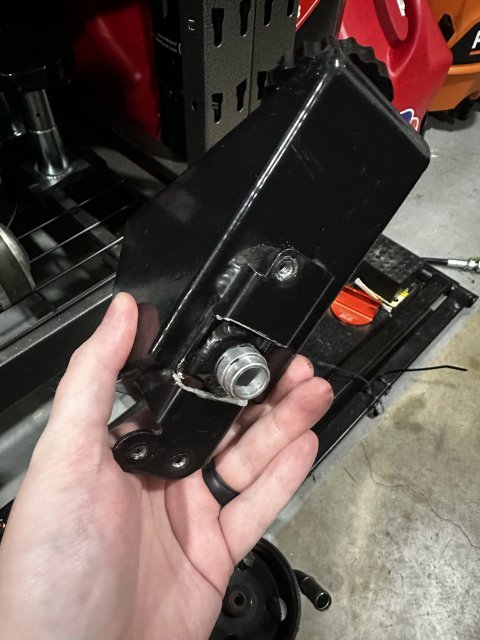

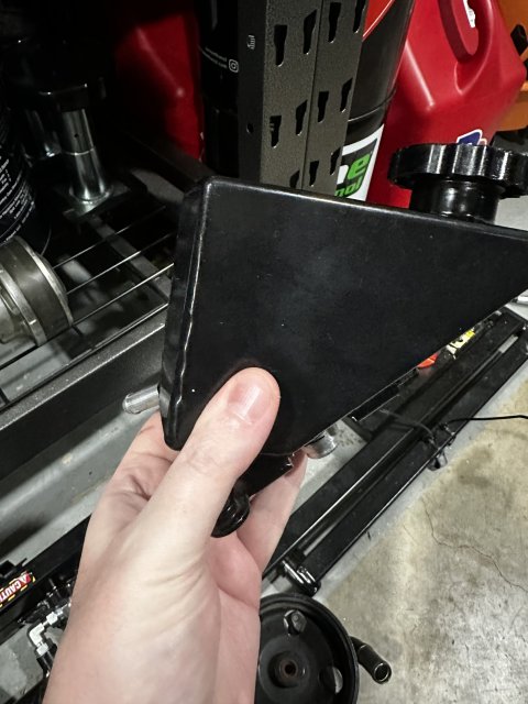

I also have a metal tank from a whipple 4.5 that bolts to the top of the stock pump, you reuse the mounting bracket from stock pump/plastic tank. just needs an o ring (I have some laying around)
View attachment 113395 View attachment 113396
The reservoir cap on the metal tank needs to be relocated to the other side for that to fit.

#78
Good to know!
#79
Then da lines are ass backards.
