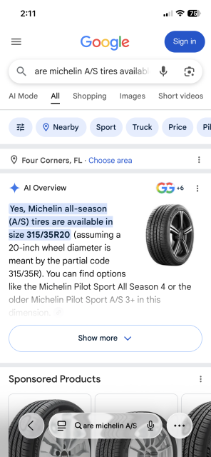

Michelin Pilot Sport 4S
33,125
68,321
5,328
17,930
Agree with Michelin’s but you probably know any performance tire has limitations in bad weather especially in cold weather. I loved the Michelin PS4 A/S tires on my Daytona. IMG_1988.png
