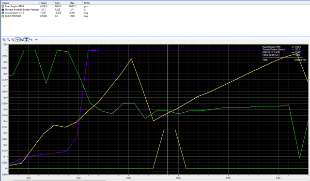

Thread Starter #145
Stock you should be fine. At worse it could pull some timing. The main thing is on a modified car with more boost to have a little extra in the tank. Could still help on a stock car depending on how good the gas is and the DA
You saw my first post in this thread correct? That was my car BONE STOCK. Definitely not fine. This thread is not about performance.

Thread Starter #147
Did you log other days at the track as well or just the one day to see if race fuel would help?
Curious if you saw much of a difference with weather as far as KR is concerned.
Those drag strip logs were in good air, like 50 or 60°F. I was getting a lot of knock as you saw. Race gas helped.
I have other logs, I can post screen shots if interested where I tested on the street the following summer. Same thing. On 93 I was getting a TON of STKR on 93. Like 3-4 deg throughout the RPM range. Started mixing in 109 unleaded race fuel and re-testing and the higher the octane went the lower the STKR was. On 93 I actually had LTKR logged which is bad.

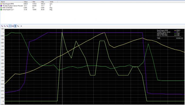

Thread Starter #153
I went and found these logs from some summer street testing back in the day. This was June in TN so figure 90 degrees and humid.
First log is on Shell 93. Knock all through the WOT pull in 3rd gear.
Added unleaded race fuel to bring the octane to about 100 and re-tested. Almost zero knock.
