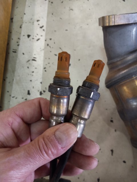

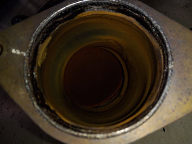

Results of Boostane on O2's & Cats after over 4 years & 8k miles of use.
Come to your own conclusion on how they look but to me they don't look bad & the orange color came off the O2 easy with just scrapping it with my fingernail.
3,787
8,951
Come to your own conclusion on how they look but to me they don't look bad & it came off the O2 easy with just scrapping it with my fingernail.
Can you scrap the build up off the sensors inside the O2 sensors? The outside doesn’t mean much except to say the inside is the same or worse being their heated sensors.
You have a good bore scope to take a peak at the valves?
To each his own on this topic, it’s not for me anymore, don’t know what I’d do if E85 where not available in my area. O2 sensors and spark plugs are easy to change, exhaust valves and seats aren’t, they where the game changer for me.

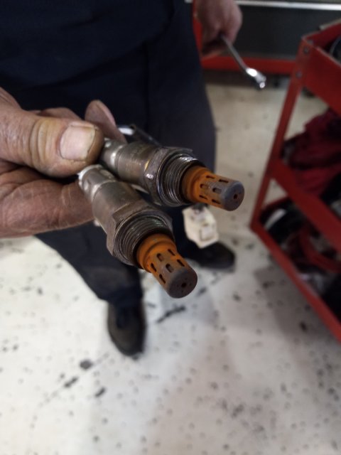

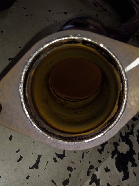

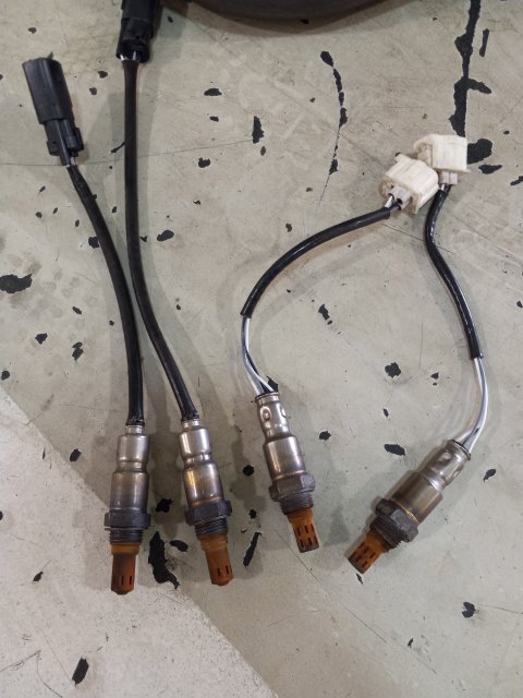

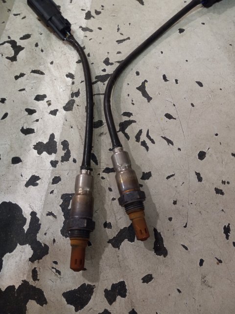

They wouldn’t swap me parts unless they flashed the PCM so I took the stock PCM with me and the tech actually changed it, flashed it, and put my tuned one back in while I swapped out from the trunk my old cats removed just a few weeks prior for new cats and old O2 sensors for a new kit with 4 of them in it plus manifold studs. I brought the cats thst where on the car with brand new ones I snagged for $200 last year. it was a pleasurable visit for once I stayed with the car the whole time was nice, even the service manager came out to talk to me and look at the car, she was a woman, she said she had to flash it, I said not a problem with the stock PCM. The new cats are in the attic sealed in the box with four oxygen sensors and new studs for the manifolds that are still in a sealed box yet. I just put 4 new oxygen sensors in with my rebuild so I took them and gave the tech the four originals I took out and they were fine with that. Didn’t touch my car except for changing the PCM, didn’t even get lifted up. I gave them a five star review afterwards. A6E3AAF1-E350-4A7F-9EDC-B50A57129FB8.jpeg 4C6807FD-046E-4269-929E-27DCD52787AE.jpeg EF203041-F405-4EF4-829E-8BA72F5EFEE4.jpeg EFD032CA-6E34-4313-8DBE-62335C378632.jpeg 5B67B3CC-237B-4003-B64F-FC6CAAF31B3D.jpeg

They wouldn’t swap me parts unless they flashed the PCM so I took the stock PCM with me and the tech actually changed it, flashed it, and put my tuned one back in while I swapped out from the trunk my old cats removed just a few weeks prior for new cats and old O2 sensors for a new kit with 4 of them in it plus manifold studs. I brought the cats thst where on the car with brand new ones I snagged for $200 last year. it was a pleasurable visit for once I stayed with the car the whole time was nice, even the service manager came out to talk to me and look at the car, she was a woman, she said she had to flash it, I said not a problem with the stock PCM. The new cats are in the attic sealed in the box with four oxygen sensors and new studs for the manifolds that are still in a sealed box yet. I just put 4 new oxygen sensors in with my rebuild so I took them and gave the tech the four originals I took out and they were fine with that. Didn’t touch my car except for changing the PCM, didn’t even get lifted up. I gave them a five star review afterwards. View attachment 64372 View attachment 64373 View attachment 64374 View attachment 64376 View attachment 64377
Good move, that makes it nice for everyone.
I saw that they put new studs in the flange also.
