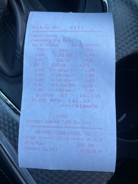

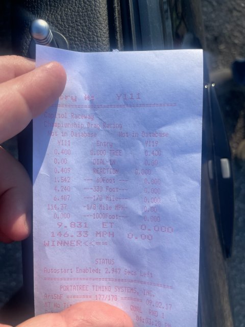

We took a phone call from someone on Sunday. Yes a Sunday and not even a customer. He was having trans issues the whole way down the track and even out of the hole. He made 3 passes and was wasting a track day. He called had him send his tune over. We only touched the transmission tune and he picked up almost 3 tenths. We get asked all the time if a trans tune is a worth it. Yes, a good tune is very much worth it.
Here is his slip of his best pass before the trans tune
Slip after only a trans tune

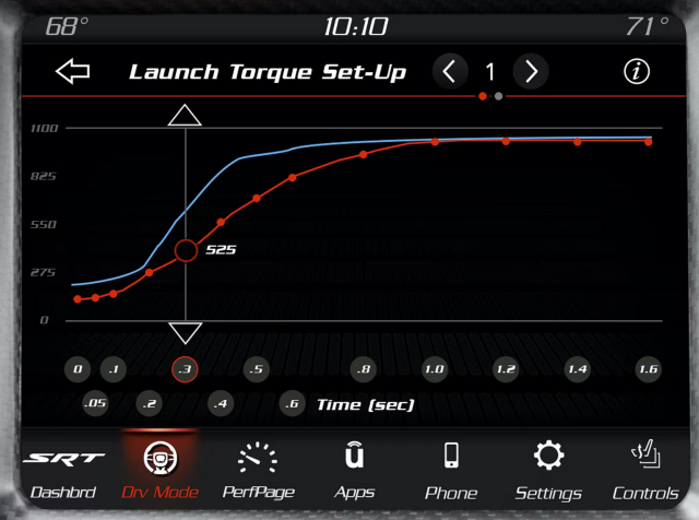

For the next pass he asked us to look at the engine side. We didn't add any additional max timing to the car. We just adjusted the timing ramp

I know these time slips lol... https://www.hellcatforum.org/threads/live-action-from-fumanchu182.6592/page-61#post-312938 cats out of the bag, I have hired Jon to help me tune, I had a trans tune in place but was on a stock one for testing.
Is First tune a Barth tune???
First tune was a stock TCM tune. It was due to the fact that I just installed a Pure transmission and was testing, @Jon-MooredPerformanceLLC has Pure singing like a dream now and it's only going to get better. We weren't able to touch the timing cause of bad e85 (tested e75).
THE ANSWER IS YES A TRANS TUNE IS WORTH IT!
