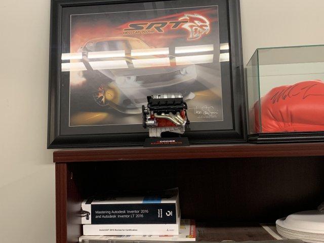

I’m staring at it in my office as I type this. It is definitely a small block. ;) I also just realized my bookcase needs a dusting. :p
