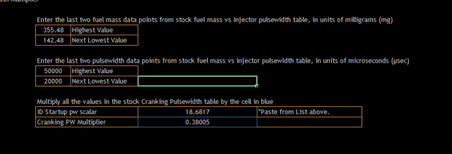

@Speedy! I assumed the same thing with table 3400 and that is what I did yesterday. So if we both assume it we must be right :p I had all that going yesterday. It could have been worded way better.
The only thing I don't understand is the part I highlighted in red but I'm wondering if it means what I did here. I contact support Monday. I'll post back my findings and a copy of the data in the tune so someone in the future can use it.
Jon, what's the question on the above? If you're wondering why the same value repeats, it just mean no more granularity was required.

My original post the spot I highlighted in red in the last pic is the part I’m not sure I’m

Who are you and what did you do with @Speedy! You always need 1000WHP on the street! After reading this thread I'm glad I went with the XDS injectors insead of the X2's. The data is straight forward and the tunability so far on 93 has been a breeze. @jonx96 how much timing are you removing up top till you know where your fuel trims will land? Also in the photo you highlighted, I hate how ID just doesn't give you granularity for that data. What I do is interpolate and then tune the data. Why make the PCM work harder?

Well Don't I feel like an idiot! I finally came back to this today.
All you have to do is enter the stock data in the spreadsheet from the stock tune.
Changing the highest value and next highest value cahnges the multiplier amount.
@Speedy! I'm not sure if that's what you were trying to explain to me. But I had tunnel vision. So after I read the instructions again it made sense as soon as I read it. I'm going to update my first post with this info so people in the future don't have to read through the comments.
