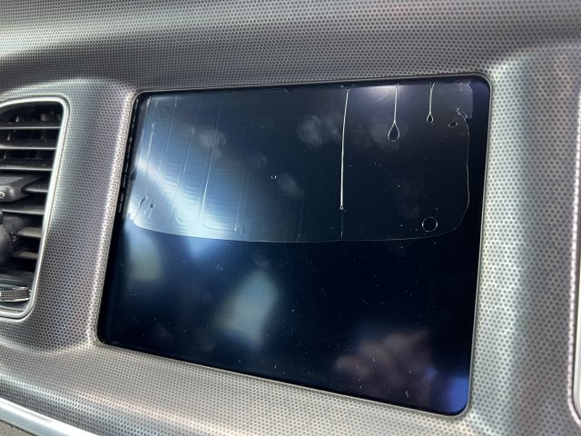

I called Dodge Customer Care and they said no, they would not cover the replacement. Oh well, they did replace my windshield under their goodwill policy when I was outside of the 36k warranty. I figured they would not replace the screen.
For your reviewing pleasure (closer to 60% delamination): 5D4E3230-2AD5-4998-A9F5-85B2B8145222.jpeg

For your reviewing pleasure (closer to 60% delamination): View attachment 77716
Wow, that looks really bad ! Surprised it's still working. Mine had about 1/2" at the top separating & it was making the system go nuts - like it was randomly pressing icons & selecting stuff. It was making me crazy driving around having random crap pop up :oops:
Sheesh, I would have replaced it long ago had it gone crazy like your previous unit…I too am surprised it works fine.

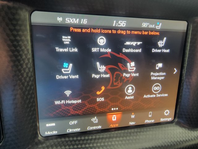

They were able to get me in today. Took 15-20 minutes. Tech was cool. Looking like a new unit as it has a different feel (much faster)
Mine never had SRT Dashboard graphic.
check all your controlc carefully. with the Demon, those '21 and newer radios have a few incompatabilities
- chiller on full-time, so no AC
- front defrost tries to start AC, as well as front defrost
- and more
- and more
Will do. Haven't scrolled through everything yet, but will check this week. Appreciate the heads up.
