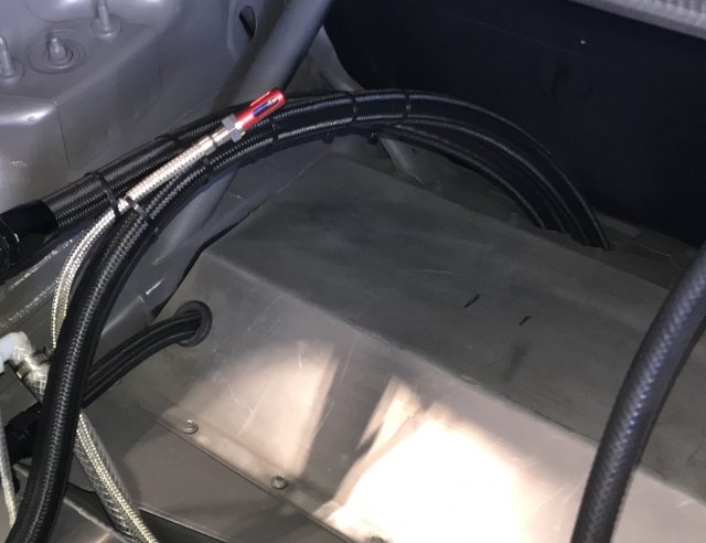

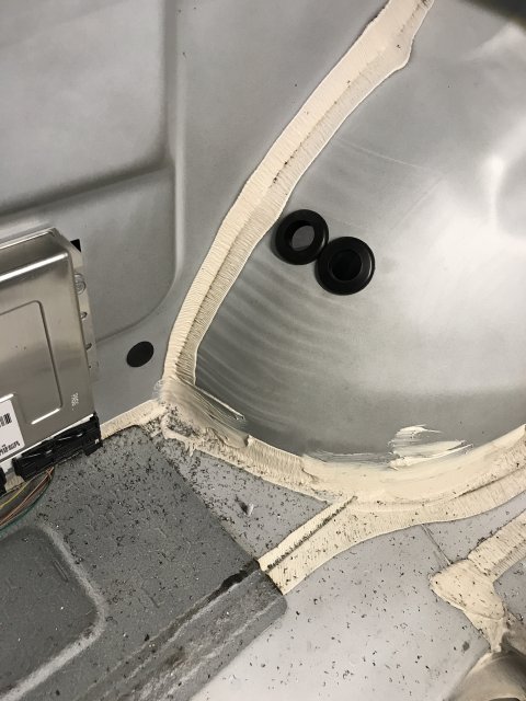

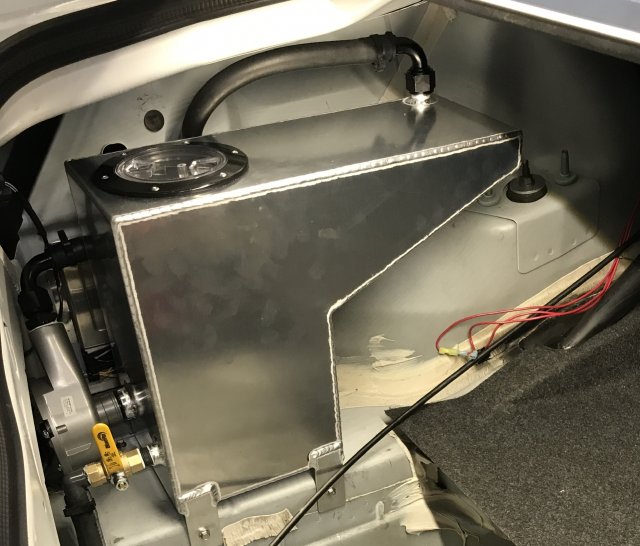

Maybe I do got something 🤔. I changed to the side mount box when we put the fuel cell in the car. I ran the lines thru holes drilled in the wheel well. I do have some pics. FBB4D8B7-53EA-4DDE-A688-10189C3277F5.jpeg E5E283A6-6870-4189-ACF9-9B016369BE58.jpeg 10180D14-24FC-415F-B6A5-9DC9B3F60FEC.jpeg

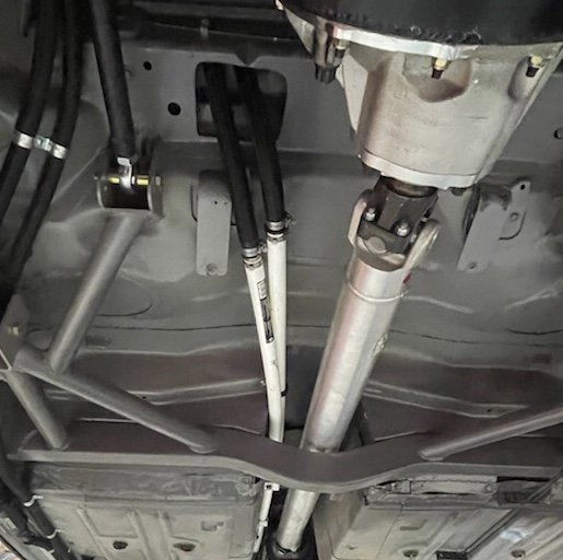

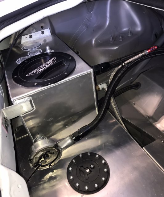

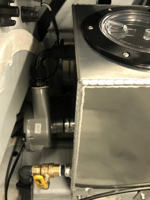

This is what I’m doing now…. We’re running huge 1” lines to that DragPak intercooler so had to figure out where they could go. With fuel lines running under the left side and brake lines down the right… we went up the middle. 169A5EE2-5036-4169-9F05-B305800B5CF1.jpeg F4F6F614-DBB9-4F37-8802-2F7B741CC21A.jpeg 0FE3E6F8-2463-41A0-BD3D-C4B0C43122BC.jpeg
