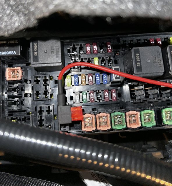

Just cut that wire (whatever it’s for), strip it, insert it into the blue crimp fitting and crimp it.
8,750
7,679
Don’t touch that metal part with the car on you might get shocked. But that needs to come out and that fuse needs to come out.
8,750
7,679
What else do you have wired into the car besides fuel pumps? That’s the accessory fuse, I have an add a fuse in there for my chiller 3 way valve and drag valve
8,750
7,679
8,750
7,679
If you still have your stock pump installed, then your tank pump is probably wired there for 12v ignition on signal, and then direct to battery for actual power and then grounded where that fuse box grounds to the body.
8,750
7,679
Unless you have other gauges or a chiller installed. Your fuel pumps wouldn’t be ran off that and should have their own inline fuse along with a relay, depending on how they were hooked up.
8,750
7,679
What all else do you have wired up in the car that’s aftermarket besides the ice tank pump and dual pumps?
8,750
7,679
One good thing about doing all my stuff myself I know what I did how I did it and what I may have goofed lol

appreciate you trying to help.
AlleyCat
AlleyCat
#1332
970
854
Oro Valley
16 HC Challenger
Thread Starter #31
nada. all stock wiring.
8,750
7,679
That’s probably for your tank pump then. Replace it with an add a fuse and check the fuse.
8,750
7,679
Put 2 10 amp fuses in the add a fuse
8,750
7,679
Just need the add a fuse and a pair of wire crimpers

Thread Starter #35
Car is running with it disconnected. And it looks like it is coming off the ice tank wiring.
8,750
7,679
Yep, that’s probably your culprit. Real simple to fix man. Just make sure the car is off.Pull the fuse, from the add a fuse to that green fire, make sure you have 2 10 amp fuses in there, plug it into the fuse box and see if that fixes it. Save you a lot of money. If it’s not that connection there’s probably a relay somewhere. If not, then maybe your pump is dead or your stock pump is causing a ton of resistant which i doubt. Did you hear the pump in the trunk running at all?
8,750
7,679
That wouldn’t come unplugged all by itself just by taking the fuse box cover off. Maybe, but highly unlikely
8,750
7,679
Disclaimer to do at your own risk lol, but it’s literally just an add a fuse. The way it was done before was very janky and imo unsafe
8,750
7,679
There’s still most likely a relay though - that fuse should just be giving it a key on source, but would need to see. Would be surprised if were running the pump off of that but guess anything is possible. But an add a fuse might fix your problem
8,750
7,679
That’s a power source, not ground by the way. The ground wire is most likely to the body where the negative battery cable and that fuse box goes to, just a stud/nut in the trunk
