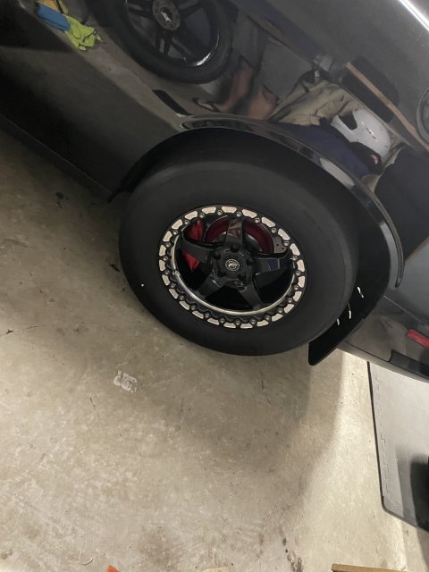

Before filling I torqued down to 10 ft lbs. then did 15, then 18 using a paint pen to mark studs done in a star pattern per Forgestars recommendation. I will have to say this is now a safety concern for me and will be doing my own beadlocks in the future. Discovered a ticking time bomb on the old pair. #mechanik never put the tire in the groove… BADE4A86-5574-4961-B7C7-F560A46F932E.jpeg

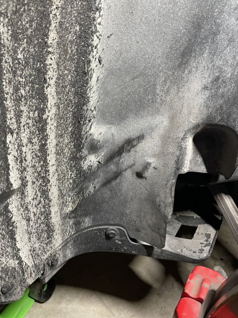

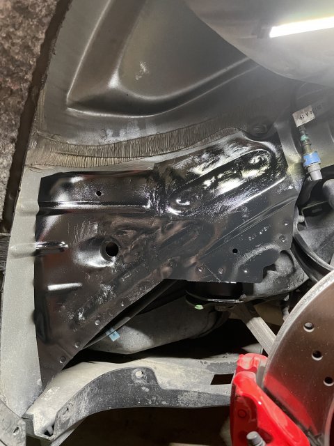

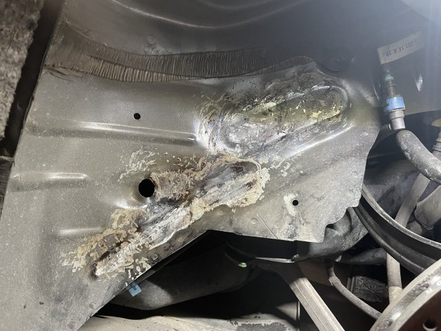

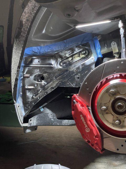

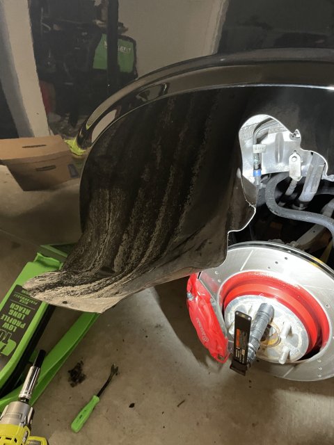

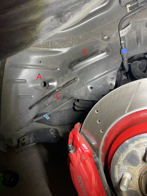

To add to the thread, this is how you bang out your ribs fumanchu-5000 style...
Step 1: notice that with your 305 there was small rubbing (that's what she said...)
Step 2: peel back the banana
Step 3: identify the enemy
Step 4: use torch to heat and a 3lb hammer to basically get some therapy in...
Step 5: sand a little to get ride of crispy paint, clean with acetone and mask off overspray.
(light coats to start off, five minutes apart, did a total of four on each side)
step 6: remove masking, mount wheel and slip finger between (that's what she said...)
Revel in the chonky ass stance she has...
On the other forums @FFBOS mentioned a 3mm spacer, I have them on order. Will drive once the spacers have arrived just for "insurance"...
