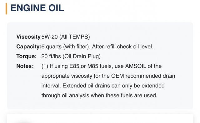

The v6 flex fuel cars all call for a heavier weight, and it’s due to the e85

@Unholy707 I'm gonna have to go check those flex fuel vehicle manuals again. The only thing I saw was to run a tank of 93 at least once every oil change (I think that's what it said) but I didn't notice a variation in oil viscosity recommendation. I'll look that up tomorrow.

I’ll see if I can find it again, it was mentioned in length for the charger interceptor upfitter package for maintenance. This is from amsoil for the charger flex fuel (factory recommended weight)

I scanned through the Ford F150 owner's manual and can't find anything about changing oil viscosity for flex fuel, but does say run a tank of 93 once an oil change.
