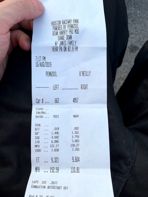

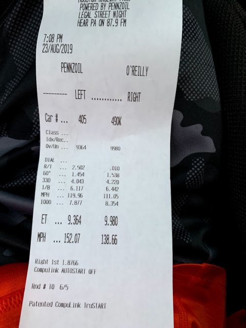

There was a Whipple A8 Hellcat that ran 9.11 without Nitrous. Here's the article that was done on it earlier this year.
https://www.hotrod.com/articles/1140-plus-rwhp-2015-dodge-challenger/
Also, I've run a couple 9.3's @ 152 in 2500+ DA on my first few passes with my Whipple setup and I'm just getting started. For the moment, I'm not as quick as my 9.132 stock blower pass but that should change real soon. I'm just waiting for a more consistent track surface to work with.
Timeslips? See attached for my 9.3's.

Here is the reality with the Whipple and KB. They hit so hard off the line that you can't 60' with them. So you have to turn them down to get them to hook. What does that do???? It kills your 1/4 time. I make over 30 mph on the back half. 1.40 60' is the best I have ever been able to get out of my car. The stock S/C is leaps and bound way better than the Whipple and KB. This is info coming from a guy that has done everything you can to make the Whipple fast.
I have watched WhipCats build post on the other forum. He kept doing everything I had already tried a year before he did it. I was one of the 1st to do so many things to this car that others are now trying.
What I would tell everyone after 3 years of RND is pulley, tune, run e85, cold air intake, and use light weight wheels and tires. That is all you need to do to the car. Stock exhaust and stock gear will net you the best results.
This is what I've always suspected with those big blowers. Bigger is not always better, learned that years ago from a buddy who went to a 4.2L (or was it 4.5L) KB. He had to lock the bypass open to drive it on the street meaning it made less power than what he started with unless he was at the drag strip on Q16 or something.
The 3.0L IHI blower might be a nice compromise if they ever come available for individual purchase.

I stand corrected a hellcat with a race motor with a ported whipple went quicker than 9.50 (hotrod article). HPindy is right, lets start a separate post on your build. I would love to hear the specifics of the build.

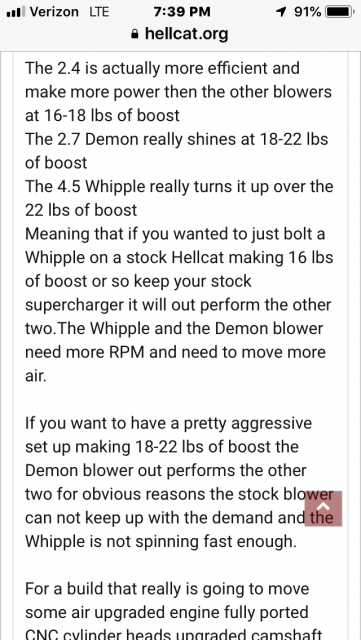

88AC28C1-5DBD-4142-A883-F2469C83F7D8.png Damn, you guys where right, I should have made a bag of popcorn before starting at page one of this debate.
I remember seeing this clip on blowers, there is truth in blower efficiency and what the right size for the intended application brings.
