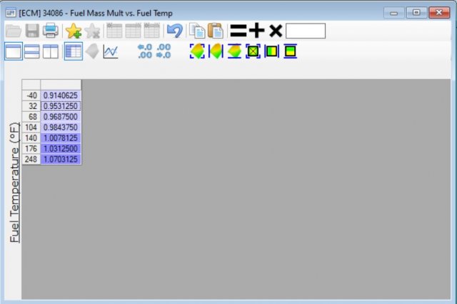

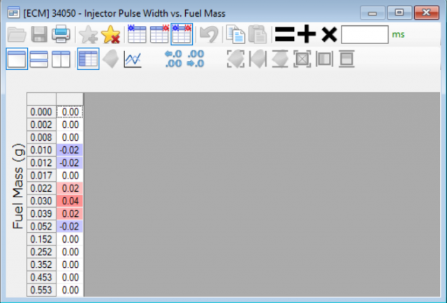

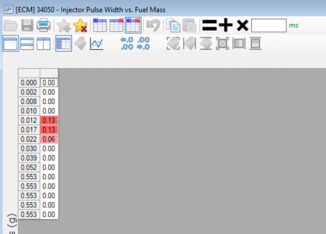

So here are the following tables and how I modified them. Fuel Mass vs Fuel Temp.

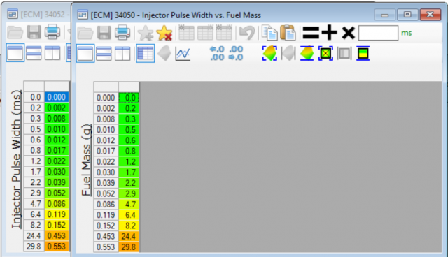

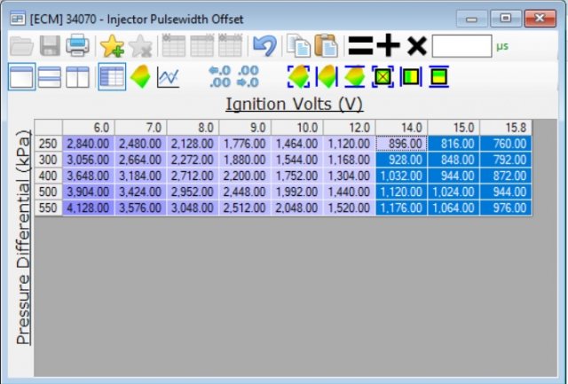

Inj. PW vs Igntion Vs Pressure Differential
(For this table the stock data ends at 16, I interpolated the values for 15.8 using linear interpolation.)

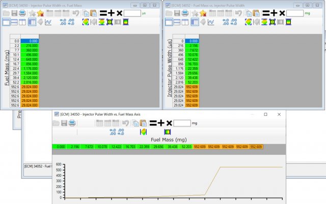

Then I modified the following tables, I changed the readings to grams (g) and (ms) after I was done with the ID data. These tables are inverse and need to be setup accordingly that way. These are the most important tables to get right from the start. The values you see here are not the stock data you will start with and I wouldn't recommend copying them and using them, my car != your car.

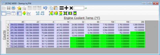

So the next two values are directly from the excel spreadsheet. The Startup Inj PW Scalar has a hard limit of 16 in the PCM no values above this will be accepted. Hasn't been an issue so far.
Then I adjusted the Start Inj PW with the data from the excel as well.

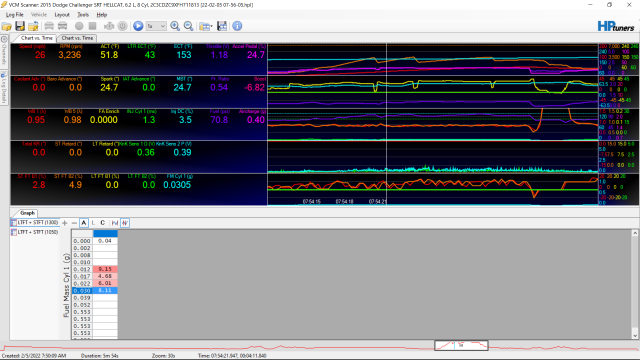

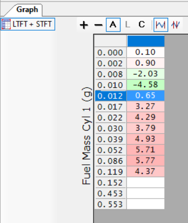

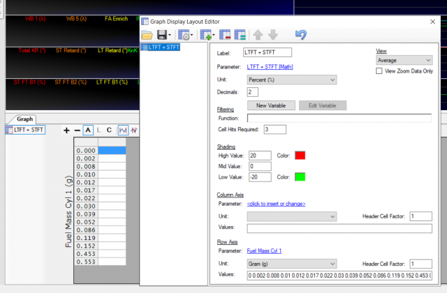

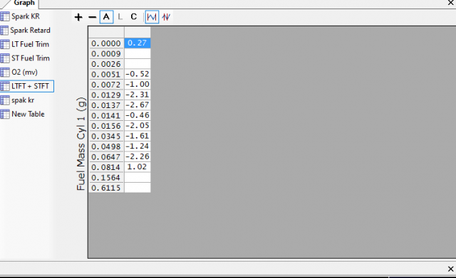

So with these injectors I have no idea where WOT will reside in the fuel mass vs LTFT + STFT histogram. Speaking of this is how I setup my histogram in VCM Scanner:
(keep in mind the photo above is not where you will start out with the stock data, I'll explain in a bit)
So to start I did some idle tuning. Exactly as that, started the car and waited two minutes to see where the fuel trims, after a minute or two I had some data for the down low ranges and adjusted as necessary. The delta for down low wasn't bad. Just had to remove some fuel as the injectors are "fat" with the plug n' play data. From revision 1 to revision 2 this is how much was removed:

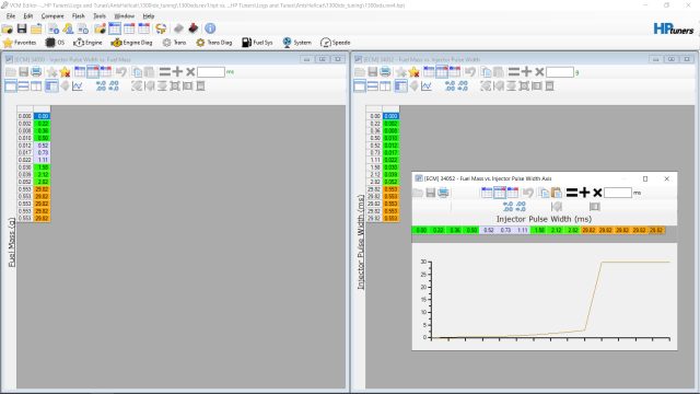

When you update the Inj. PW vs Fuel Mass table you have to update the inverse table as well, they always have to be inverses. From here I started just driving around town. Nothing more than 3k in acceleration and nothing really crazy speed wise, no highway/wot pulls. From revisions 2 to revision 3, I had to add and remove some here and there:
Not a lot, the injector data is really good. Now I decided to do accelerations from 2k to 5k with paddle shifters holding gear to see where I am at. I also noticed the big jump from .052g to 0.152g and decided I wanted more granularity between those values so I setup the tables in the tune accordingly:
(this is why my histograms look the way they do). So with two revisions I have a fully driveable around town Hellcat with 1300XDS injectors installed. Of course there is plenty of data to still get. I need just more time. With the snow coming in and cold weather not cooperating for the tracks it just takes time. Maybe soon I'll be able to get to a dyno that my friend runs (a calibration dyno) and get better data for WOT. It was a fun experience and I want to get this 93 dialed in so I can then have some fun with E85. After revision 4 I started doing some more driving and now that I have a lot more granularity I think I overshot my values and run a little lean. But +/- 5% in either direction should be the goal. On the highway she crusies just fine.
IMO I think that my WOT will rest between .119 and .250g. If that is the case then I will adjust the tune for that granularity and adjust my histograms as necessary. Thank you for coming to my TED Talk yet again and hope I spread some good knowledge. If I got anything wrong or missed something important please let me know. (all credit goes to this thread: https://forum.hptuners.com/showthre...Mass-spark-advance&highlight=fuel+mass+tuning, this is a realy great thread, give it a read!)

Using that histogram was a good idea. I didn't think to do that and spent a LONG time working my injector data. I'm gonna go back and look at that, but I'm assuming you're logging a PID for "fuel mass cyl 1"?

Correct, I am logging that channel. In retrospect I looked at one of my recent OST tunes and they did the same. Left the scale the way it comes from the data. I also am going to go back to the drawing board on this and start over, I was thinking it was linear interpolation. Which makes sense, fuel trims are a polynomial curve, the math makes sens in my head that way. Maybe thats why I over shot… Should have zigged when I zagged.

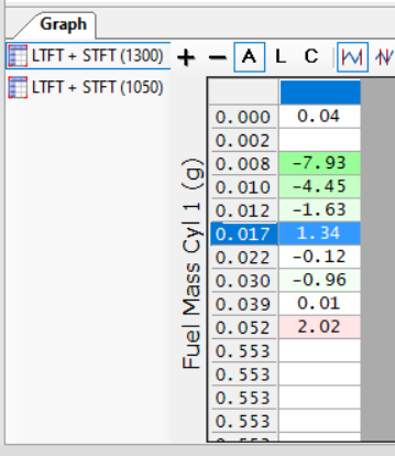

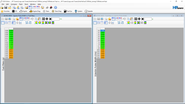

So now that I have a modicum of interest in the car again, weather is still shit, I went back and re-did my injectors to look like the plug n' play data from ID to start with. Revision 1 is shown below:
Revision 4:
The delta:
Once I start tuning for the track though this car's datat will probably look nothing like this lol. When I was working with OST we had just one tune for street/track and it worked wonderfully. Hopefully I can get that magic back myself.

Revision 1 was idle tune, 120 seconds of idle. Revision 2 was a checkup on idle as well. Revision 3 and 4 were semi long trims. Just worked on revision five this morning in which I was using paddle shifters to shift to 4k rpm and then command a shift. Here is the data from this morning.
As you can see its below the 5% that you would fight with potentially and overshoot your values. Here is what I learned aobut the paddle shifting. Leaner than I would like so I took the data for the entire trip and made adjustments.
Going to do some highway driving soon, the issue is the weather is really cold, 32* F so the air is very oxygen rich. However this might be good prep for the killer chiller.

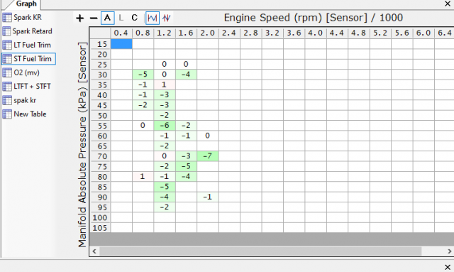

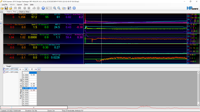

Since you are doing it your self I'd plan on getting those numbers a lot lower than 5 percent. This is just a log I have. I have dialed my injectors in even a little farther than this. This looks to be a pretty short drive here like really short. But you get the point
Take a look at this ST graph this is how I gauge how close I really am.

@jonx96 100% agree. Went back out and dialed them in, don't know why they were lean.
I'm not worried for the -4.45, would rather run rich than lean. The -7.93 is from accelerating and then having to brake hard, some fuel was pumping in as the throttle was closing, not worried about it. For now I'm done doing drivability tuning. I am more worried about doing some WOT tuning now. Since the weather is really cold and getting colder 30*F today, I might just rent some dyno time to get a base tune, at least at that point I'll be ready to do some WOT at the track and get some real data.
