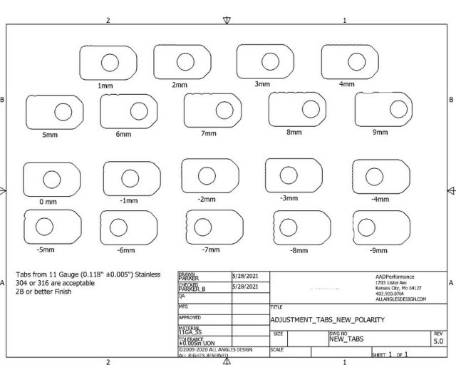

We can tell you what you need. The arms come with "2" installed with 4 and 6 with them. 2 should be stock length. What i did it put the 4 in them and went to shop. From there every number moves it about .24. You will be looking for 0 to -30 camber. At one point I had 5 in one side and 7 in the other. I have demon springs now and with the higher ride height that were changed to a lower number. I would order 3, 5 and 7 tabs or after installing the 4s and checking i should be able to tell you what you need.
You can break up an order with 2 different tabs being they come 8 tabs. You need 4 per side. You need 8 for the front why they are sold like that

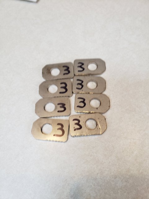

The aad stuff is pretty easy. Also I went in and wrote numbers on them so I didn't have to look at chart every time and figure it out. The notch system they use on the tabs isn't the best to determine which one it is 20231005_160544.jpg
