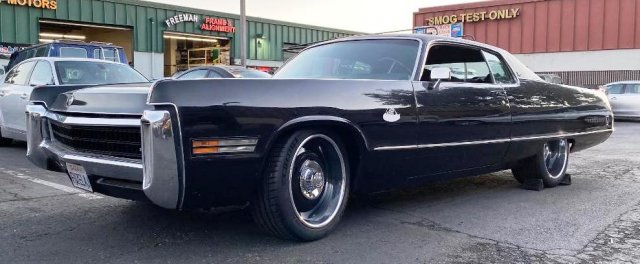

1972 Chrysler Imperial GT w 2018 Durango parts
I have a 1972 Imperial. I drive it fast on road rallies and eat people in little vintage EuroTrash cars when I do.
Had a problem where I burned 3 of the 4 brakes off the car while intimidating an Austin Healy just west of Lake Tahoe.
So I redid the car's stoppers and am stumped:
