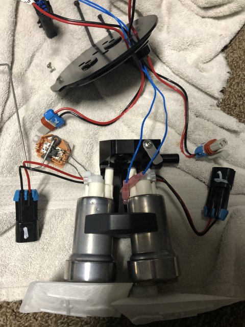

I think I found the culprit.
20,159
That is a huge crack.

Thread Starter #24
yeah I’m guessing they work independently but don’t hold pressure independently.
Dude that sucks !
it does but I’m relived to at least know where to go from here. Man that was driving me nuts lol!

Thread Starter #25
I was always EXTREMELY gentle handling it so I have know idea how it got there
20,159
So it is completely through the body of the unit? Sorry to hear about that, but could be worse - could have spewed gasoline all of the place. Those are not a single piece, right? So you can replace only the one that is bad? Is there a wider photo of that area in context with what is around it?

Is it possible they came that way, shipping damage?
Unlikely, but damn.

Thread Starter #28
Its probably possible to change that one pump, but I'd prefer they just send me a new hat assembly. Funny thing is, the plug photo up top almost shows the crack, but that was taken without the pumps all the way out, upside down(my phone almost fell in the tank lol). I was just looking with my phone to see if the plug was there. Wasn't until I took everything completely out until I saw the crack. I'll get a wider shot of it tonight
Unlikely, but damn.
To me, the quality and the packaging seem top notch... I have seen the way ups drivers can sling packages around

They're already sending me a single 285 to replace it. (y)

Maybe it's the angle of the picture, but as I look at that assembly, the overall geometry of the pumps and the bracket don't look good.
Am I seeing that wrong? The pump on the right looks like it's tweaked toward the centerline. The cracked pump looks like it would be tweaked towards the centerline if it weren't for the crack.
Thoughts? :unsure:
Thoughts? :unsure:
I see what you mean.
Thoughts? :unsure:
The hat was just loose in that picture and I think it throws it off a bit. Here is a better shot. Two stabs on the pump look like it hit something at some point
