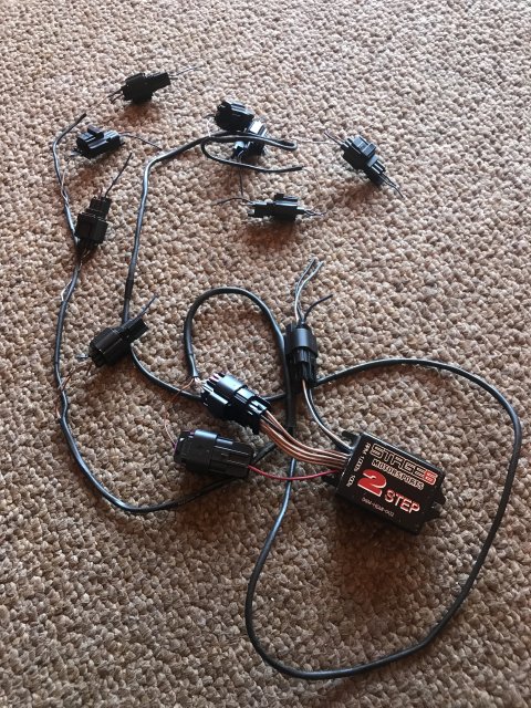

I have the 2-Step and plug-n-play harness that simplifies the installation that I no longer need. It worked perfect in my car. Retail on the Stage6 is $425 and the MXA harness is $300. I’ll sell the whole thing for $400 shipped. 2384CB80-1D40-4A4F-82A3-77BC14F82709.jpeg 741E9B04-48D4-47C8-95B2-7318C38735F2.jpeg
