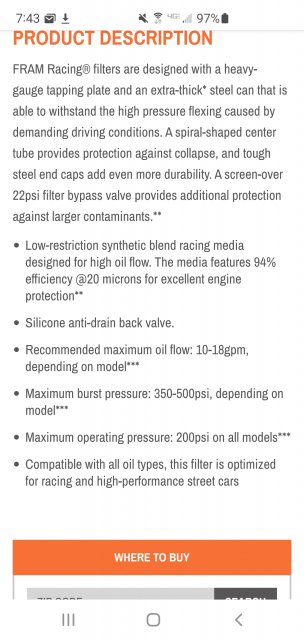

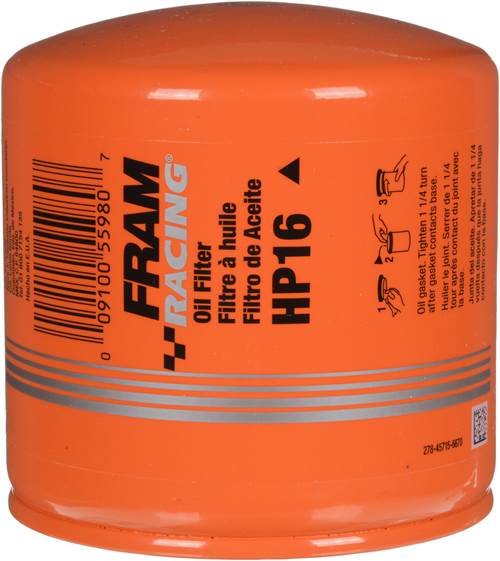

Saw this as an alternative to the Wix made Viper (white) Mopar oil filter. Along with the Ultra, they make a racing filter that fits the Hellcat. Wonder how these specs compare with the Viper filter?
Plan on using Viper filter going forward, but this might be a good one in a pinch?

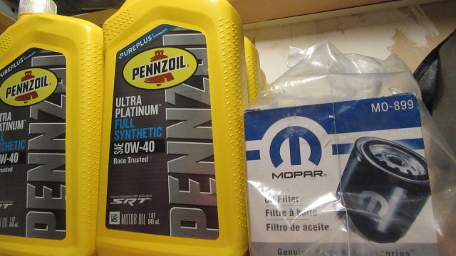

I use Pennzoil and the Wix filters.
Years ago Fram was the top filter. Apparently not anymore.

This is my combo from day one. "Racing" filters were never my thing.

The FRAM racing filters are a solid design, and I have used them for decades on my racing engines. BUT, I bought one HP16 recently for the Hellcat, and low and behold, "made in China." :mad: They had always been made in USA. I sent that POS back from where I bought it. I will NEVER use a Chinese oil filter on any of my engines. The FRAM Ultra-Guard are also a very good filter design for daily type applications, and have been Made in USA up to that last time I bought one. The FRAM business enterprise has undergone a lot of merger/acquisition/divestiture activity over their history, and apparently they have gone the more, if not totally to the cheap Chinese way since my employer divested them several years ago. Buyer beware. Glad I have enough Mopar filters in-stock to the last the rest of my life lol

22microns isn't very impressive
12 or less...

Are there any spec’d at < 20?

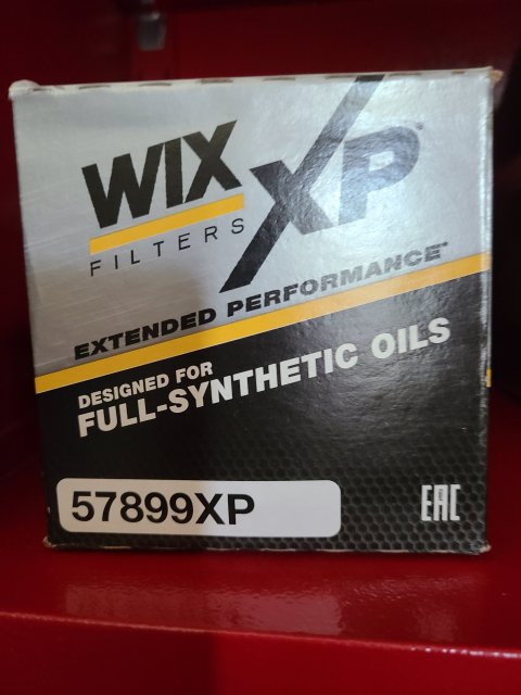

What's interesting about the "XP" versions of the WIX filters is they "open" them up, presumably to allow for greater flow as they get older???
When I saw that, I stopped using the "XP" versions of WIX filters and went back to the normal versions.
