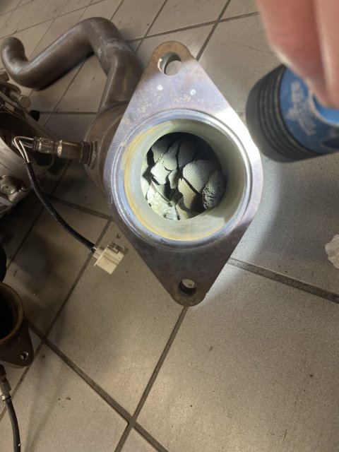

Clean those wasp nests out of your cats man there’s your problem

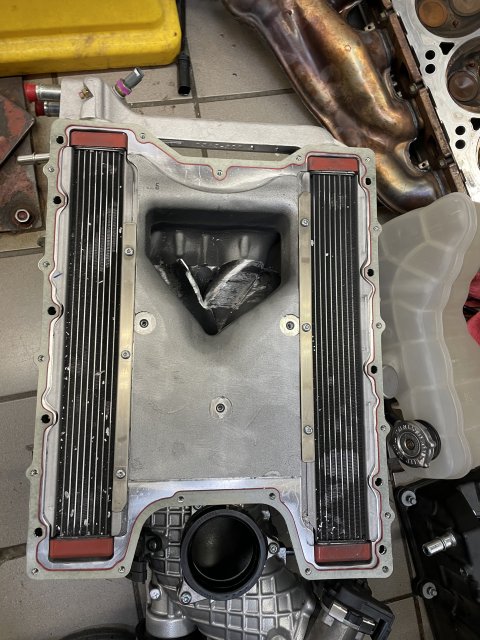

getting started on replacement.
