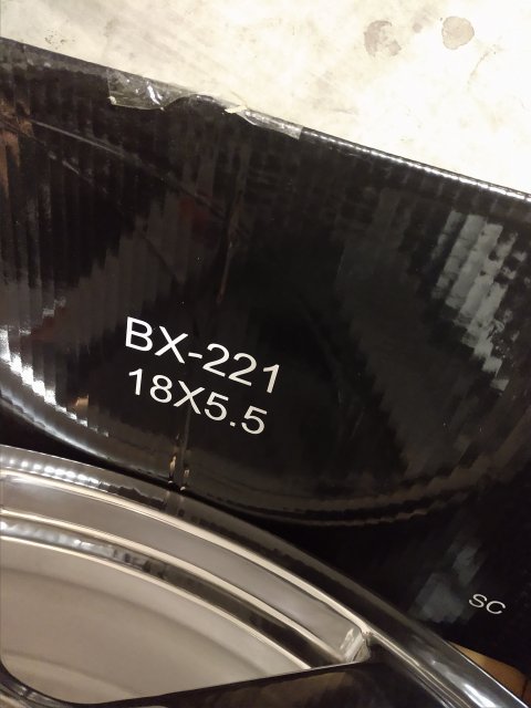

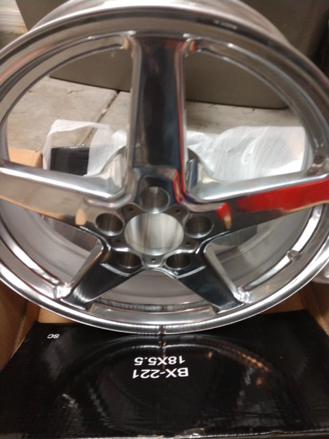

I ordered two. The box states 18*5.5 instead of 18*5. The bolt pattern by eye looks ok. I have not taken off the wheel yet to test fit them. The Chinese numbers do not match the ordering numbers. But sometimes that is normal.

Just the basic racestars. I took a tape measure and from inner lip to inner lip it is 5 inches. I do not know why the box states 18 x 5.5. probably all is ok

What is the part number? 18x5 is correct.

92-850445. But I do not see those numbers on the wheel.

Sorry my mistake I misread the part number. These are the specs for your wheel maybe they just put them in the wrong box?
Race Star Drag Star 18x5 polished wheel for the Dodge Hellcat are direct fit. All Race Star Industries wheels feature an extremely lightweight one-piece alloy construction with a lifetime structural warranty. This wheel features a traditional 5 spoke star design for a classic muscle car appearance.
Features
Lightweight but strong one-piece alloy durable enough for street use and drag racing applications.
Drag Star wheels feature a 5x115 Hellcat bolt pattern for a direct fit.
Engineered for additional clearance when using larger brake calipers.
Race Star Lifetime Structural Warranty
Center caps are included.
1-3/8" shanked lug kits are required and sold separately on our Race Star Lug Nut Page
Wheel Specifications Size18x5Bolt Circle5 x 115Back Space2.13Offset-20Center Bore3.07Load1000Wheel Weight18

I just did a test fit on the wheels. They fit. But are almost up on the calipers. But when the tire is on I assume they will clear by a bit more. The weights will have to be put on by the front part of the backside of the rim due to clearance issues. I am happy I decided to sweat some this morning and do a test fitting.

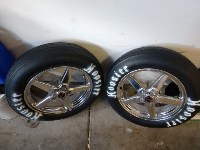

Mounted and balanced
