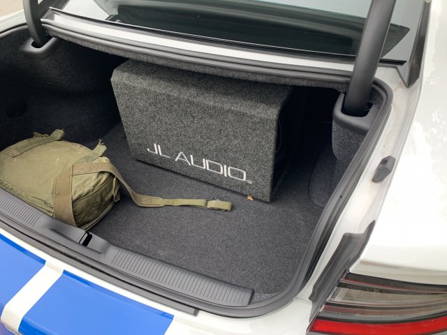

All I put in mine was an AP4 module which you have to have and a JL audio 6 ch amp. It will blow your mind how good it sounds.
I would love more details, if you can ask your installer. I've read the stock amplifier is 11 channels, so how does the JL Audio power up 11 channels, or is your installer using two amplifiers, the JL to power the front 6 channels and using the stock amplifier to power the rear speakers and subwoofer?

Something to do with the ohm's but they ran 2 pair of speakers off each channel. because i had a JL 12" sub they disconnected the factory sub. They called me during the install and had everything shut down except for the sub on the factory amp and the output was so pathetic they recommended just disconnecting it entirely, which I had them do. The factory amp only runs the speakers in the middle of the dash and the back, everything else is ran by the JL 6ch amp. They do make an 8ch amp which they said I would need if I wanted to retain use of the factory subs. Since I have the heavy hitting JL W6 12" I didn't see a need for the factory subs. I am still waiting to hear back about ohm's and load etc.

Awesome, that is what I thought they did, using four channels of the amplifier to power the front stage and probably bridged two channels to power your JL Audio 12" sub, which probably pounds now.
This gives me exactly was is needed, and an 8 channel amplifier would be more useful if one was to separate the front mids and tweeter and go active with an amplifier like the Helix V Eight DSP, or keep the stock passive set-up and power with that JL Amplifier, or I would go with a Helix P Six DSP mainly because I want better Bluetooth streaming and Helix makes a Bluetooth device that processes the Bluetooth much better than our stock system.

They didn't remove anything. On the Chargers I am actually not sure where the factory subs are. Ill post a pic of the sub in the trunk and then the amp installation after work.

See attached. Hopefully it helps. If you need more clarification etc by all means ask!

This is great! Looks like you have more than originally stated and that subwoofer must be banging with the mono amp. You have two amps, and what looks like the JL Audio XD600/6v2 and the XD600/1v2, with the 6v2 powering the Front stage and that 1v2 powering the subwoofer.
Great system, must sound great! I cannot wait to dive into this build. Appreciate all the posts and pics!!!

Yes I’m sorry I thought I mentioned I had 2 amps. One is the 6ch amp for miss and the other is a 4ch amp bridged to the sub. It sounds like you would think a $1700 option HK system would sound like, absolutely badass.
