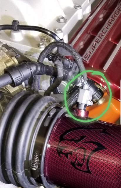

Exactly. I too want to know where this sensor is being read on the air inlet tube.. 20200512_161223.jpg

I wonder if it's used in the calculations. Like it takes reads from ambient, pre throttle body IAT , MAT and uses them to calculate something?

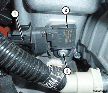

On my 2016 the dash digital gauge labeled "intake air temp" is the one by the throttle body I "think". Do the 2018 and up not have a MAF in the intake tube any longer?

No . The MAF is gone on 2018 and up . Just the PVC and IAT sensor now .

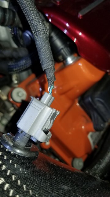

Add me to the want to know what that temp sensor in the intake does. Just installed the JLT in my 2019. On a brief test drive I had 75F ambient and 110 to 130 shown on the IAT gauge. Didn't learn much as traffic was about like there was no Covid....damn people, these roads are supposed to be just for me!

Roger that. My old eyes were seeing things.

Thanks to @Hpindy for the info on some other temp PIDs to monitor. I added manifold air temp and intake air temp. Intake air temp must be read in the intake tube as it was 4-5° F over ambient. Manifold air temp had the highest readings and aircharge temp (in HPTuners) lined up with what the dash gauge reads as "intake air temp".
