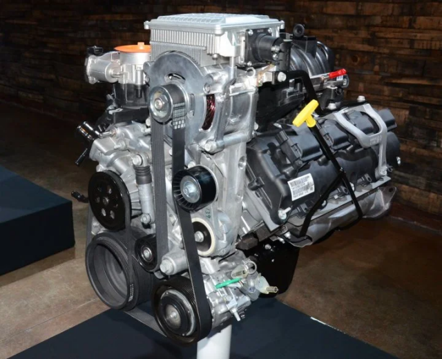

You can see that the bracket covers 3 of the coil packs... and accessing the bottom bolt requires going in through the wheel well and everything that entails...

Gross

It doubles as the alternator, and draws off a 48V battery system when engaged.

And the entire thing pukes when the battery is at the end! F that!!!

So what it’s just an electric motor that spins the crank faster? Why not just put a small procharger. Dumb

Like how does it even work

Just like a tesla motor--either putting power out (motor), or taking power in like a generator/alternator (regenerative braking mode).

A Tesla motor spins the wheels, what does this spin? The crank?

Yes. Via the accessory belt.

How is that good for the engine? Weird

I always wondered how much hp it is putting through the belt. What? Like as much as my lawn mower? :ROFLMAO: Seems stupid, which is why I didn't buy it even though it was at a great price.

Google says on the 5.7 the etorque adds 130 ft-lbs... and that's through the 6-rib accessory belt. Wonder what that does to the bearing life on all the accessory pulleys.
