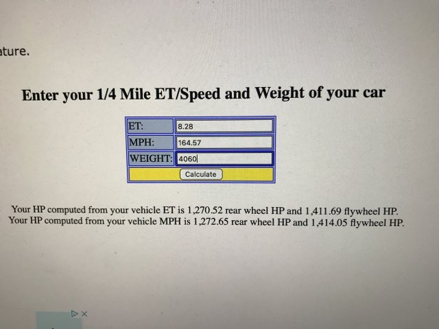

Wallace Racing Calculators….. mph at the finish line is most accurate as the et is affected by starting line performance (60 ft) where as the mph is not. Density altitude affects hp and consequently on track performance, so these calculations are a picture of that time and condition. Not a one time shot like a dyno pull. 655DF604-2E59-4216-B2C9-C6D173612D6A.jpeg

I used this to calculate how fast I was going to run in the 1/4 before I took the car out and it was pretty accurate, I used their other calculator

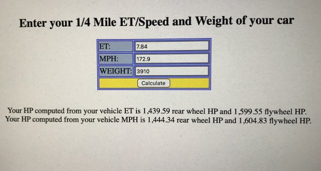

Putting those numbers in for the blue car…. We saw 1400rwhp on the dyno at a 3000+ da. So at sea level (actually -200 on this run) the numbers come up as you would expect. 5291372B-F8BC-4E46-8D67-9C971341D82C.jpeg

Your car is 3910 with you in it?? Dang

Says my car makes between 848 and 905 at the wheels which checks out, but I made those passes at 2000 da 90 degrees out, so it’s probably on the higher side

That’s the “other” shop car. The blue widebody that runs 7’s. That’s with Nichole (our 115 lb driver). Mine weighs 4050 now with me in it. 63BC8D6C-830F-48DD-B45A-A426BE20EAD6.jpeg
