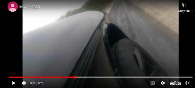

watching your video's I do not see a lot a lift in the front
Disregard the crappy track. I will not be returning
What the heck kind of track is that. Looks like some sort of backwoods kind of deal. I think we need to find you a real track
I agree. Bare in mind.?. My time slips arent from that track. I only posted the clip to show front lift? The previous posted clip is from our local 1/4 mile track in bristol

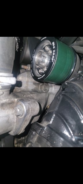

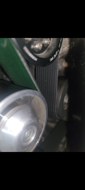

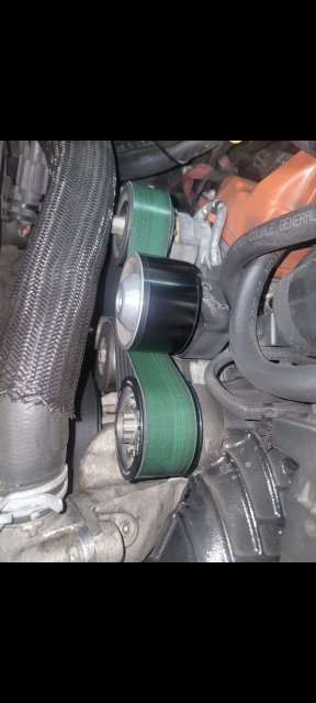

Ok so me pushing 18psi i shouldnt be having that issue. I wonder if its just where we tuned it for e85 in winter and now its summer.
Btw heres some pics of my belt.
