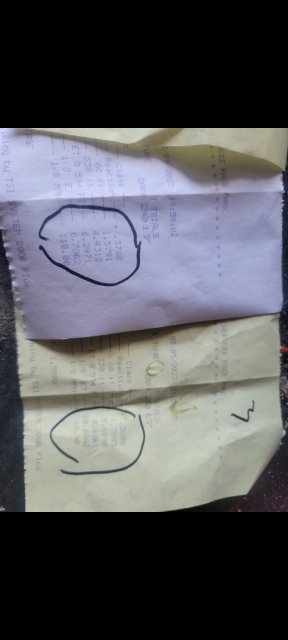

if everything looks good in the data log my next step would be taking the diablo suspension controller off if you are spinning. Stock I was mid to low 1.5 60 ft. MPH has my wondering though

Exactly why I asked about the mph and showed those time slips where I ran high 9’s (we are yet to see the time slip to do the math). Sixty ft isn’t just about hooking up. You also need to have the power to accelerate and if there’s a issue then it’s going to show up from the top of that time slip to the final mph. I don’t see where the 134 mph number was shown. That isn’t all that strong for a modded e85 motor unless the da is real high. I think there’s more going on than just traction.

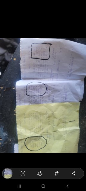

Thread Starter #80
Slips from last night. 1/8 miles Screenshot_20230506_133129_Gallery.jpg Screenshot_20230506_133126_Gallery.jpg Screenshot_20230506_133126_Gallery.jpg
