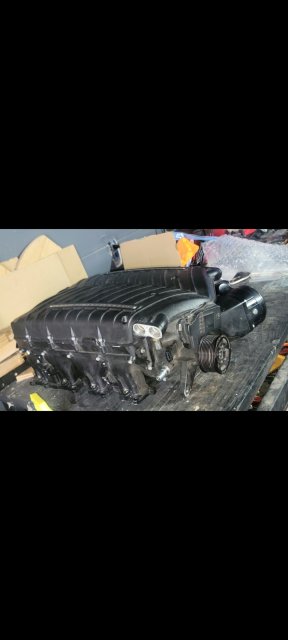

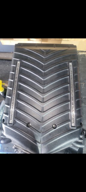

Got the Whipple. Will keep everyone posted on this build

Hopefully you clean up that blower, my OCD is triggered :ROFLMAO:

Yes the blower will be getting a bath before install lol
