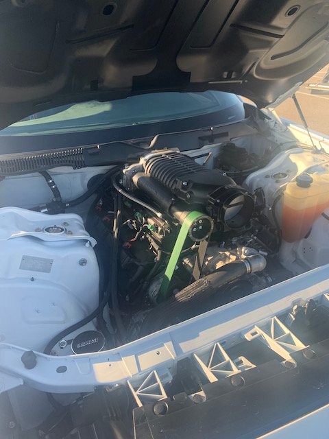

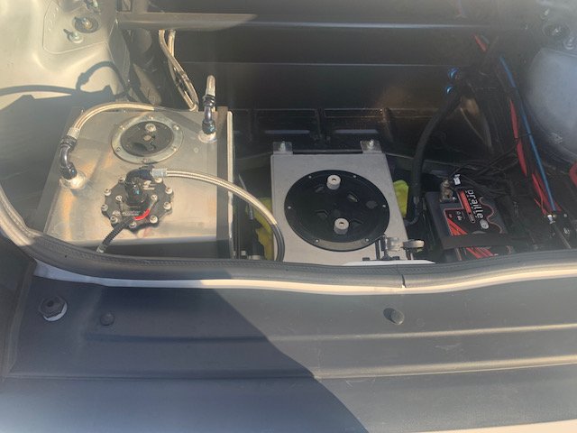

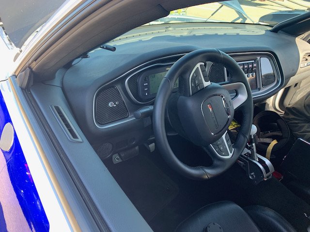

I had the pleasure of pitting next to a Drag Pack at the legion of Demons in Houston. It's a really nice ride, and was brand new to the owner, so he was just getting used to it. Pretty strong but has at least a little ways to go to be 1800 HP and 7's kind of strong
Skip the first half of the video, (I'll work on my editing skills) was 8.80 can't remember the mph
https://youtu.be/qL1181o2m2k

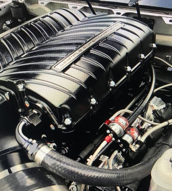

AAF45C62-B71D-4205-A879-9CC5C999A350.jpeg 5932B5B4-74AE-439F-B6D0-86412923D89C.jpeg That’s the old one. New one is a completely different animal.

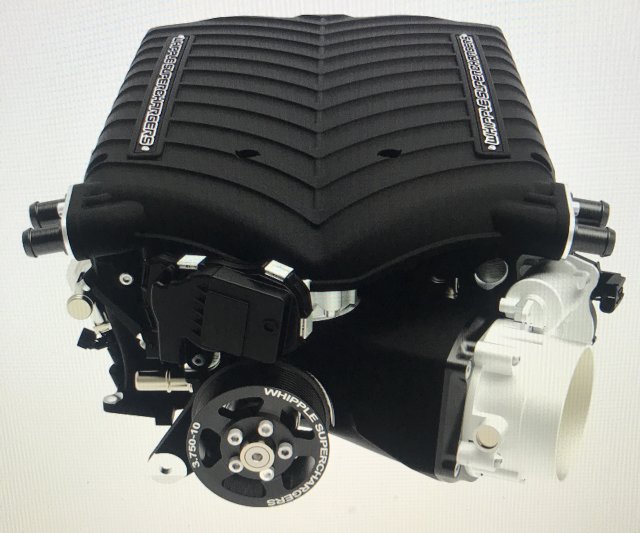

A couple things to know about the new 3.0 Whipple ready to hit the market. 1..... don’t confuse it with the 3.0 DragPak version. There are obviously some differences. The plenum volume on the old 4.5 was extremely compromised (as is performance) in order to fit under the stock hood. That was a marketing decision that was made because it’s hard to sell something that requires you cut or replace the stock hood on the car. Looking at the DragPak version it looks big. Comparing the pictures of those with the ones just released of the new street version, it looks like the volume under the lid may have been reduced some as well. The shape is different and the IC plumbing is different. So basically..... I wouldn’t expect the street 3.0 being released now to have the capabilities of that DragPak (it will fit under the hood however). Inquires by myself and others about using the DragPak 3.0 on our Hellcats ended up with us being told that it can not be done using the OE electronics. The throttle body is manual and a stand alone tuner (Holly EFI) needs to replace the PCM. Personally, I think this new Whipple will doom the modded IHI as the choice for increased performance over stock. Time to sell those while they’re still worth something 😂 27C8E8A4-FFFB-432E-872A-5F9F3C4DEB7F.jpeg 80EFBD6A-E219-449C-9C01-6EB4EA1F1231.jpeg
